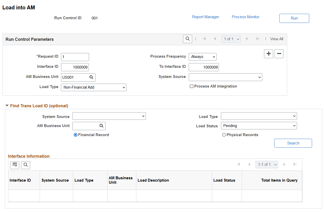

Use the Load into AM page (RUN_AMIF1000) to run the Transaction Loader process.
Navigation:
This example illustrates the fields and controls on the Load into AM page. You can find definitions for the fields and controls later on this page.
Run Control Parameters
Field or Control |
Description |
AM Business Unit |
Select to run the transaction loader for a given business unit, or leave this field blank to run the process for all AM business units. |
System Source |
One load ID may come from multiple system sources—for example, from both PeopleSoft Purchasing and PeopleSoft Payables. To run all lines with the same load ID, leave the System Source field blank. To process only PeopleSoft Billing, Payables, or the Purchasing load lines with the ID, and so on, then enter that system. |
Load Type |
Select a load type (for example, Non-Financial Add) to run the transaction loader for a specific load type. Some examples of load type values include Asset Add, Asset Capitalization, and Asset Retirement. |
Process AM Integration |
Select this option to process component change-out integration from PeopleSoft Maintenance Management. This selection appears only if you have PeopleSoft Maintenance Management installed and is not related to the interface line numbers. You can leave the interface line numbers as zero and select this option to process the pending requests. If you do not select this option, the transaction loader does not process Maintenance Management transactions |
Find Trans Load ID (optional)
If you do not already know the interface ID that you want to process, the Transaction Loader enables you to search for transactions based on system source, load type, AM business unit, load status, and whether they consist of physical or financial records. You can use as many or as few of these criteria as you want. The more you use, the narrower your search is.
You may select any of the following Load Status values:
Load Status |
Definition |
Consolidate (consolidated) |
Transactions Consolidated (will not be loaded). |
Errored |
Transaction Errors Note: To rerun transactions in status Errored, you have to change the load status to Pending. |
Excluded |
Transaction is being excluded from Asset Management due to the asset cost not meeting the corresponding capitalization threshold. A detailed message appears in the Error Message field that states that the capitalization threshold for this profile has determined that this is an expense and will not generate an asset ID. Additionally, the system inserts an entry in the audit table. |
In Process |
Processing is ongoing. |
Loaded |
Transactions Loaded |
On Hold |
Transactions are not processed. Set this status manually to prevent the processing of some rows if you are expecting another event to occur before running. |
Pending |
Transactions Not Loaded |
Replaced |
Transaction line replaced with alternate line. |
Unitized |
Transactions Unitized (will not be loaded) |
