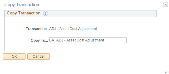

Copying Transactions
Click the Copy icon to copy the transaction in the row. When you click the Copy icon, the Copy Transaction pagelet appears:
The Copy Transaction pagelet enables you to enter a new name for the transaction you are copying. Enter a name for the new transaction using the Copy To field. The system automatically adds the existing transaction name, but you must alter it to differentiate it from the original.
Once you save the new transaction by clicking OK, it is added to the Mass Transaction List page and the Custom field is automatically selected.

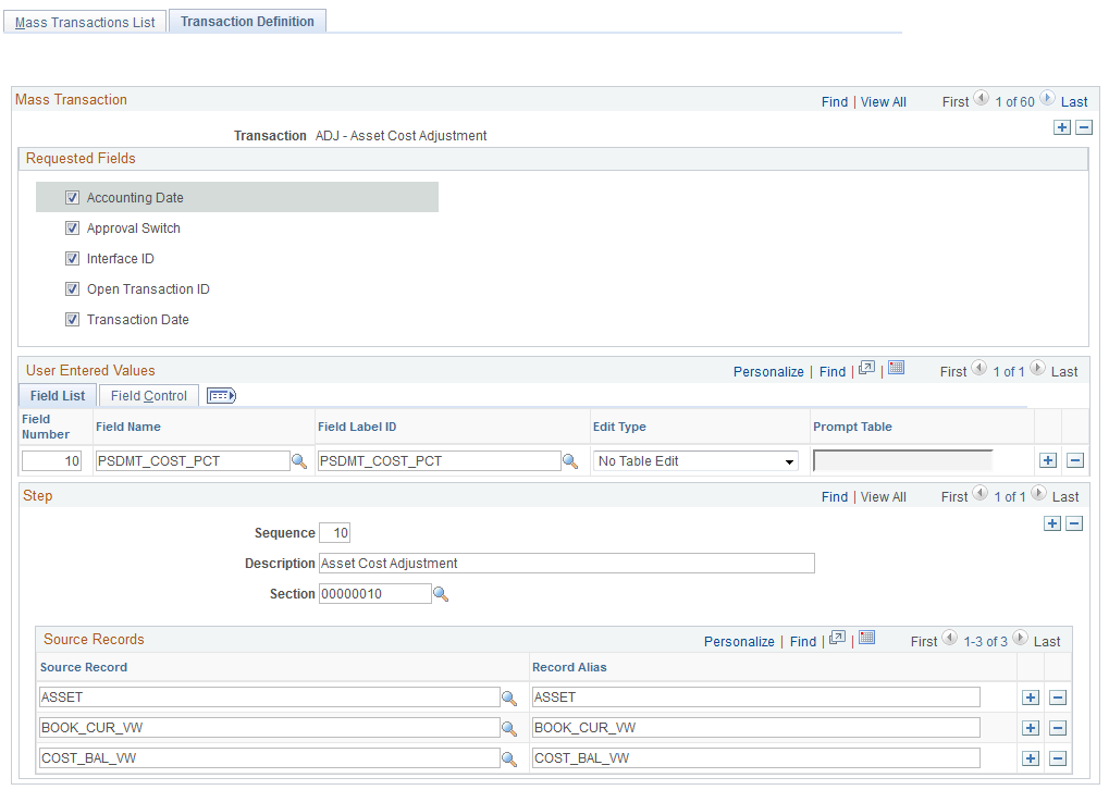

Use the Transaction Definition page (PSDMT_UNITS_02) to define detailed transaction information.
Navigation:
This example illustrates the fields and controls on the Transaction Definition page. You can find definitions for the fields and controls later on this page.
Field Control tab on the Transaction Definition page
Requested Fields
This group box displays a list of fields that, when selected, will appear on the Run Mass Transactions page as requested input parameters for the run control. Typically these are fields that are common across Asset Management tables. The fields in this group box are populated automatically from the MTM_PRODUCT_CFG record and MTM_RQST_AM_SBR subrecord.

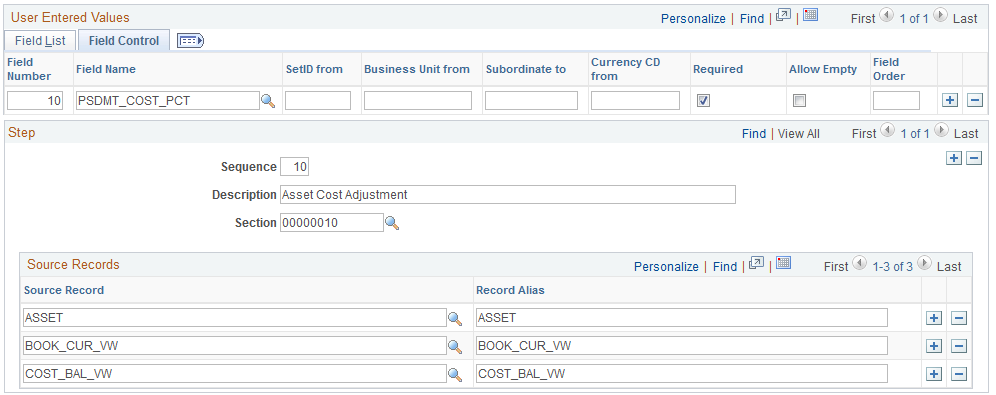

User Entered Values - Field List and Field Control Tabs
This group box enables you to define field-level user input parameters that will appear on the Run Mass Transactions page as required input parameters for the run control. These are fields that are specific to a particular transaction. Available fields are obtained from the MTM_PRODUCT_CFG record and MTM_UEV_AM_SBR subrecord are available for selection.
You can use the Field List tab to define basic field-level information and behavior, such as field name and edit type.
You can use the Field Control tab to refine field behavior, such as adding subordinate fields and requiring users to input data for the field on the Run Mass Transactions page.
Field or Control |
Description |
Field Number |
Enter a numerical value to uniquely identify the field. The number provides a sort order on this page as well as a field reference for the SetID from, Business Unit from, and Currency CD from fields. It also provides a default order on the Mass Transaction Criteria and Run Mass Transactions pages. |
Field Name |
Select a field you would like to use as user-defined input parameter on the Run Mass Transactions page. Available fields are obtained from the MTM_PRODUCT_CFG record and MTM_UEV_AM_SBR subrecord. |
Field Label ID |
Select a field label for the field. This will be populated automatically after you select a field for the Field Name. |
Edit Type |
Specify the type of field edit or validation for the user-defined field. This impacts how users can select values against the field on the Run Mass Transactions page. Available options are:
Note: When you select the Prompt Table option, you must enter the associated prompt table using the Prompt Table field. |
Prompt Table |
Enter the prompt table associated with the field. This field is required only when you select the Prompt Table option from the Edit Type field. |
SetID from |
When a field requires a SetID as a key for its prompt, enter the field number associated with the field you want to use to obtain the SetID. For example, assume the DEPTID field requires a SetID as a key for its prompt and you want to obtain this information from the BUSINESS_UNIT field, which you have labeled with the field number ‘10.’ In this scenario you will enter ‘10’ in this field. This field can be left empty when no SetID is required. |
Business Unit from |
When a field requires a business unit as a key for its prompt, enter the field number associated with the field you want to use to obtain the business unit. For example, assume the ASSET_ID field requires a business unit as a key for its prompt and you want to obtain this information from the BUSINESS_UNIT field, which you have labeled with the field number ‘10.’ In this scenario you will enter ‘10’ in this field. This field can be left empty when no business unit is required. |
Subordinate to |
When a field is subordinate to another, that is, it contains a prompt that depends on another field, enter the field number associated with the governing field. For example, assume the ASSET_SUBTYPE field contains a prompt that depends on the ASSET_TYPE field, which you have labeled with the field number ‘50.’ In this scenario you will enter ‘50’ in this field. This field can be left empty when no governing field is required. |
Currency Code from |
When a field requires formatted currency amounts based on a currency field, enter the field number associated with the field you want to use to obtain the formatted amount. For example, assume the TXN_COST field requires a formatted currency amount based on a currency field and you want to obtain this information from the TXN_CURRENCY_CD field, which you have labeled with the field number ‘30.’ In this scenario you will enter ‘30’ in this field. This field can be left empty when no currency formatting is required. |
Required |
Select this option when you want to require users to input data for this field on the Run Mass Transactions page. If you do not select this option, inputting data for this field will be optional on the Run Mass Transactions page. |
Allow Empty |
Select this option when you want to allow users to select Is Empty for this field on the Run Mass Transactions page. When a user selects Is Empty for the field on the Run Mass Transactions page, the value field is hidden and the system removes the value of that field and replaces it with a space, a zero, or null, depending on the field type. |
Field Order |
Enter a numerical value to define the order of the field. The system will use values entered here for the field sort order, overriding the order as provided by the Field Number field. This field is optional. |
Step
Use the Step group box to provide an ordered sequence to execute transactions and define the source records that will be used to build the list of filtering fields on the Mass Transaction Configuration page.
Field or Control |
Description |
Sequence |
Enter a numerical value to assign the transaction a step order. |
Description |
Enter a description of the step. |
Section |
Enter the Application Engine Library (MTM_LIB_AM) section associated with the transaction. |
Source Record |
Select the source record that will be used to build the list of filtering fields on the Mass Transaction Configuration page. The filtering fields on the Mass Transaction Configuration page will be used to create the FROM clause in the SQL statement, so it is important to include all the source records needed to create the desired statement. |
Record Alias |
Enter an alias for the record. This field is populated automatically after you enter the source record, but you can change it if you have a different alias in your SQL or need to leave it empty to use it in PeopleCode. |

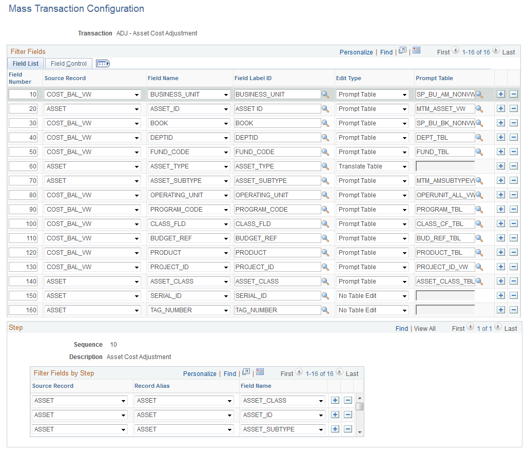

Use the Mass Transaction Configuration page (PSDMT_UNIT_DTL) to define the list of field filters available in the Selection Criteria portion of the run control page and configure the filter behavior.
Navigation:
This example illustrates the fields and controls on the Mass Transaction Configuration page. You can find definitions for the fields and controls later on this page.
Field Control tab of the Mass Transaction Configuration page
The fields you define here will be available in the Selection Criteria portion of the run control page. You can indicate whether a certain field will require input by the user. You can also define the behavior of each field—for example, whether the user will prompt for field values and, if prompting is enabled, prompt using a prompt table or translate table.
Note: The fields on this page are identical in name and usage as those on the Transaction Definition page. Please refer to the documentation for the Transaction Definition page for detailed field definitions.

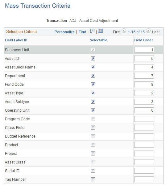

Use the Mass Transaction Criteria page (PSDMT_UDC) to choose the filter fields to display in the Selection Criteria portion of the run control page for a given transaction.
Navigation:
This example illustrates the fields and controls on the Mass Transaction Criteria page. You can find definitions for the fields and controls later on this page.
The Mass Transaction Criteria page enables you to select the filter fields to display in the Selection Criteria portion of the run control page for a given transaction.
Use the Selectable option to indicate the filter fields that will display on the run control page. Fields designated as required on the Mass Transaction Configuration page are automatically selected here and unavailable for editing.
Use Field Order to override the default order specified on the Mass Transaction Configuration page. Fields with no value will maintain its default order but display at the bottom.

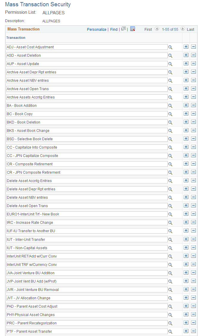

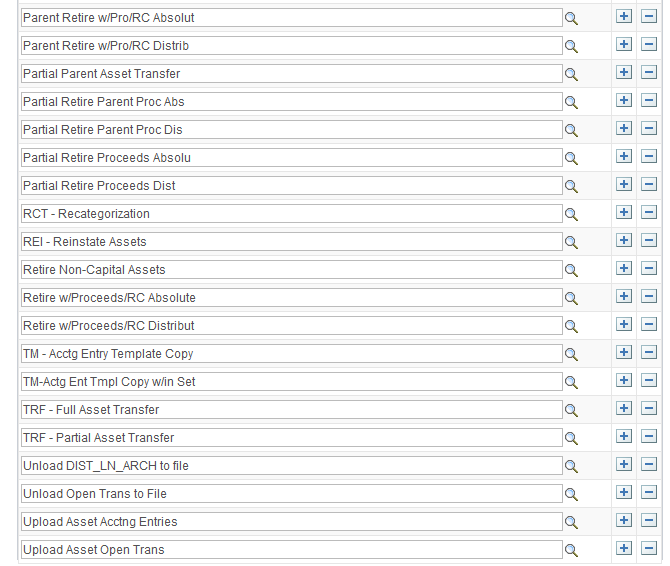

Use the Mass Transaction Security page (PSDMT_OSECURITY) to set up security for a transaction by associating permission lists with the transaction.
Navigation:
This example illustrates the fields and controls on the Mass Transaction Security page. You can find definitions for the fields and controls later on this page.
Use the Mass Transaction Security page to select a permission list, then add the transactions you want the permission list to access. Users will only be able to access transactions that are public and associated with their permission list.
