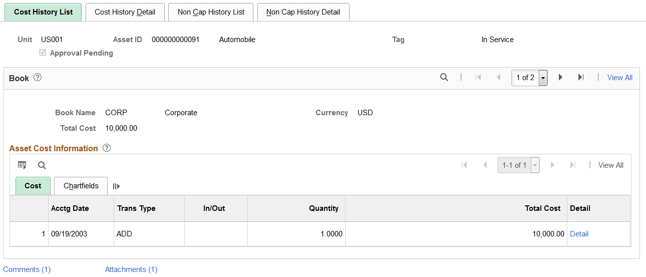

Use the Cost History List page (ASSET_TRANS_01) to view the cost history of an asset.
Navigation:
This example illustrates the fields and controls on the Cost History List page. You can find definitions for the fields and controls later on this page.
Click the Detail link to access the Cost History Detail page and review cost details for an individual transaction.
Click the Comments link to access the Cost History List - Comments page and view or add relevant supporting comments to an asset transaction.
Click the Attachments link to access the Cost History List - Attachments page and view or add relevant supporting documents to an asset transaction.
