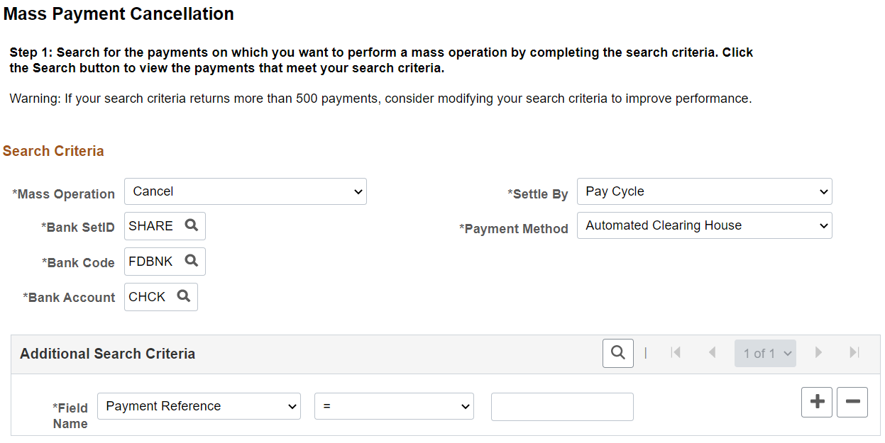

Use the Mass Payment Cancellation page (AP_PMT_MASS_CNL) to search for multiple payments for mass payment cancellation and select the maintenance operation you want to perform: Cancel, Escheat/Stale-date, Undo Cancel, or Undo Escheat/Stale-date.
Navigation:
This example illustrates the fields and controls on the Mass Payment Cancellation page - Step 1. You can find definitions for the fields and controls later on this page.
This example illustrates the fields and controls on the Mass Payment Cancellation page - Step 2. You can find definitions for the fields and controls later on this page.
Search Criteria
All fields in the Search Criteria group box are required fields. You must enter at least one field name and value as additional search criteria.

Mass Operation |
Select the processing option you want to perform: Cancel, Escheat/Stale-date, Undo Cancel, or Undo Escheat/Stale-date. Warning! After posting, you cannot undo the cancellation or escheatment. |
Settle By |
Select the settle through method, either Financial Gateway or Pay Cycle. Pay Cycle appears as the default. Note: If you select Financial Gateway, during the Mass Payment Cancellation process, the system creates and sends a message to the PeopleSoft Financial Gateway. Once the system receives a response from the PeopleSoft Financial Gateway, the search results are displayed in Payment Inquiry. |
Bank SetID, Payment Method, Bank Code, and Bank Account |
Enter bank information and a payment method to further narrow your selection. |
Field Name |
Select at least one field name and value. You may select more than one field name to use in your search criteria. Payment Reference appears as default. When you select Payment Reference, you can define multiple values and multiple ranges. The system joins these fields by the or condition. For example, you can define Payment Reference = 100000, or Payment Reference = 200000, or Payment Reference between 300000 and 400000. The system retrieves all payments that meet that criteria. When you select Pay Cycle and value, the system requires that you select a Pay Cycle Sequence Number and value as well. When you select other available field names, define a single value or single range of values for that field name. When you select the other fields, they are joined by the and condition. For example, you define Pay Cycle = Weekly, and Pay Cycle Sequence Number = 001, and Payment Reference = 100000, or Payment Reference = 200000. The system retrieves the payment references 100000 and 200000 generated from the Weekly pay cycle with a pay cycle sequence number of 001. |
