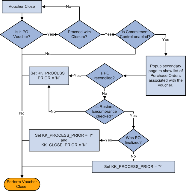

If purchase orders are associated with a voucher marked for closure, the system gives you the option of restoring encumbrance to the purchase order. If you choose to restore the encumbrance, the system automatically unmatches the voucher. If you choose not to restore the encumbrance, the system does not unmatch the voucher.
When the voucher is associated with purchase orders, and Commitment Control is enabled, the system:
Determines if the encumbrance can be restored to the purchase order.
The system generates a message asking if you wish to restore the encumbrance and reopen the purchase order. Select Yes to restore the encumbrance and reopen the purchase order. Select No and the system only liquidates the liability.
If you use matching and you opted to restore the encumbrance and reopen the purchase order, the system automatically unmatches the voucher after the Voucher Posting process, which updates the purchase order and the receiver match statuses to Partial.
Determines if the purchase order has been reconciled and finalized, and if encumbrances are established.
If all purchase orders have been reconciled, then the system prevents you from reopening the purchase orders and restoring the encumbrances and the system advises you that only the remaining liability can be restored.
Determines if the PO voucher has no associated partial payments.
If associated partial payments exist, the system does not perform the undo matching functionality.
The system uses these results to ensure field value synchronization between source transactions and referenced transactions, which are used in the Budget Processor process.
The following diagram illustrates the PeopleSoft Payables voucher closure processing logic for scenarios involving associated purchase orders and Commitment Control integration.
