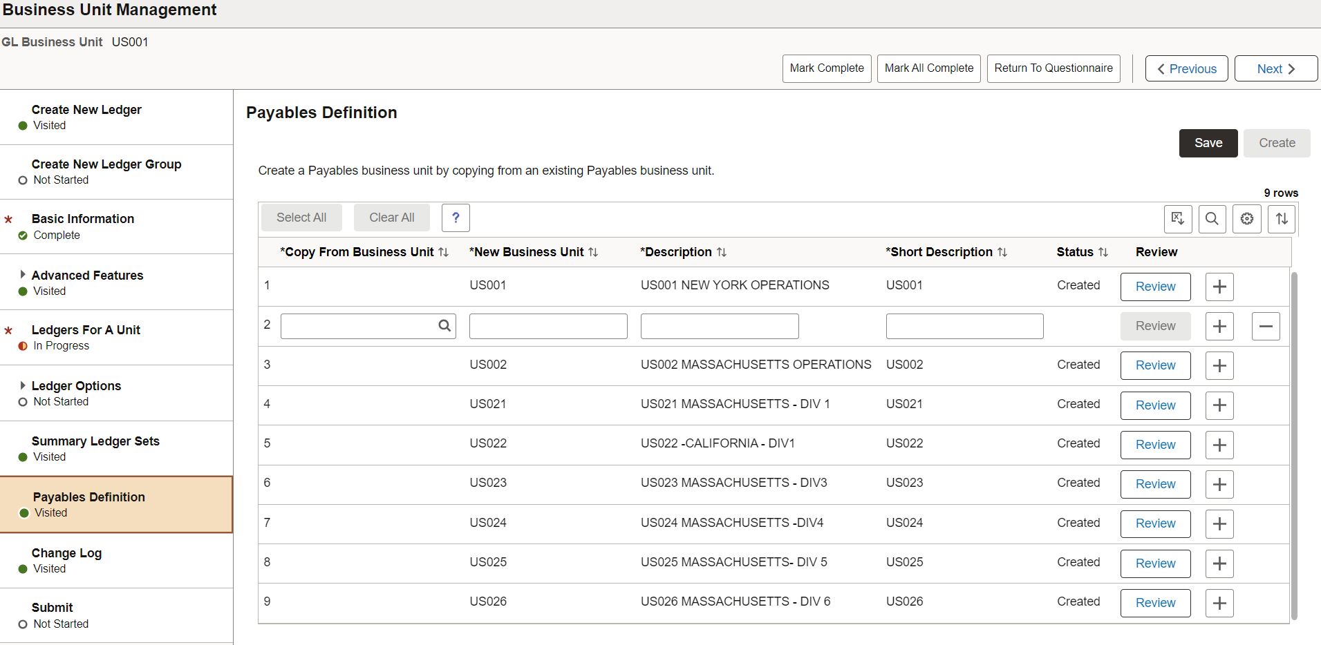

Use the Payables Definition page (AP_BU_COPY_FL) to search, modify, add, and copy Payables business units.
Navigation
This example illustrates the fields and controls on the Business Unit Management - Payables Definition page.
            | Field or Control | Description |
| Copy From Business Unit | Enter an AP business unit from which the new business unit will be copied. |
| New Business Unit | Enter a name for the new AP business unit. |
| Description and Short Description | Enter a description and a short description for the new AP business unit. These are mandatory fields. |
| Status | Displays the status of the AP business unit. The available options are:
| Create | Click to create a new AP business unit. |
| Review | Click to update the Payables Definition and Procurement Control options. Review button is available only after the AP business unit is created. For more information on Payables Definition page, see Defining PeopleSoft Payables Business Units. See Defining Procurement Controls for General Ledger Business Units for additional information on Procurement Control page. |

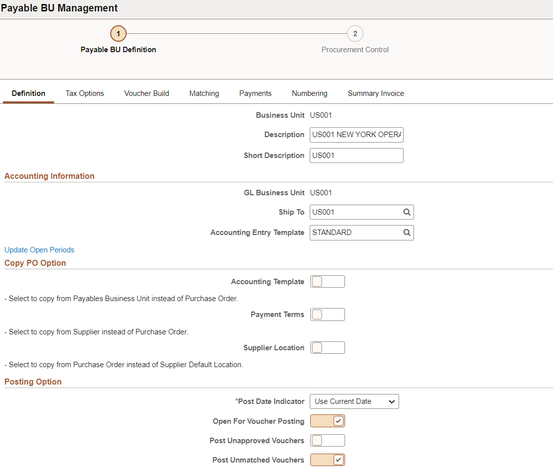

Use the Business Unit Definition page (BUS_UNT_TBL_AP1_FL) to create a Payables business unit.
Navigation:
Click Review button to update the Payable Definition.
This example illustrates the Business Unit Definition page.

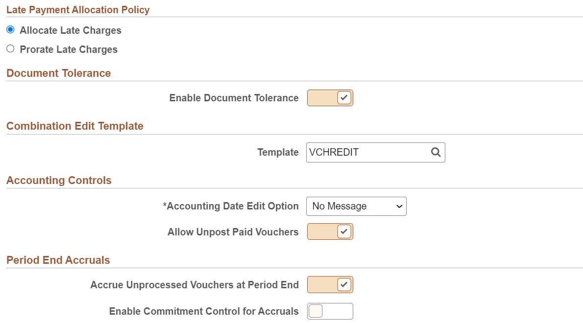

            See the Payables Definition - Definition Page for field definitions.
