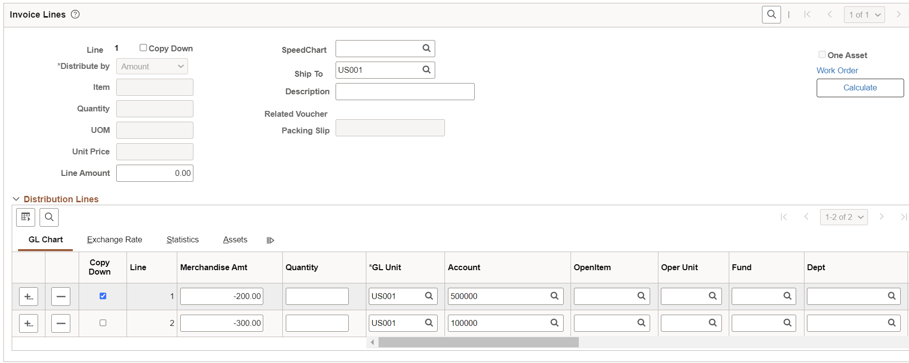

This example illustrates the fields and controls on the Invoice Information Page – Journal Voucher style (1 of 2).

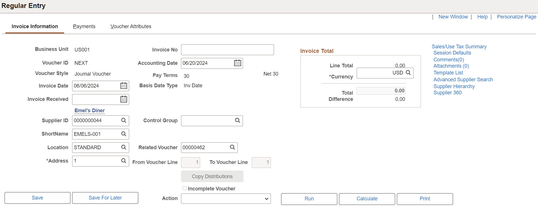

This example illustrates the fields and controls on the Invoice Information Page – Journal Voucher style (2 of 2).

To create a journal voucher:
Select Journal Voucher as the voucher style on the add search page for the Voucher component and click Add.
Enter the Supplier Name and Supplier Location.
Choose Related Voucher on the Journal Voucher header page. It will display From Voucher Line and To Voucher Line. Modify the values for specific voucher line or range of voucher lines or leave both the fields blank. Click Copy Distributions button to populate necessary header information, zero amount voucher lines with corresponding distributions of foreign amount and chart fields from the related voucher based on the options. Foreign amount is reversed, that is, Foreign Amount of Related Voucher * -1 for back out of Expense Distribution of related voucher. Copy Down check box is enabled for first distribution line of every zero voucher line. Once copying is complete, From Voucher Line, To Voucher Line, and Copy Distributions button is disabled.

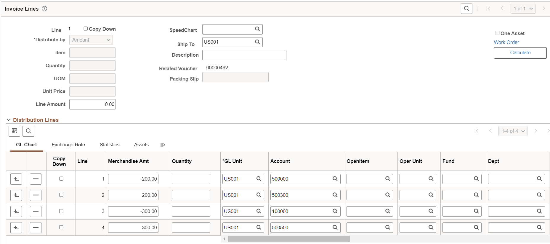

Add the new distribution line against the back out line. Enter the same amount with opposite sign of back amount and chart fields for correction.
OR
You can also utilize the Copy Down functionality of distribution to copy the distribution amount, GL Business Unit, Account, and Chart fields from back out line. The Distribution amount copied will be opposite sign of back out amount. The user can change Account or Chart fields.
This example illustrates the fields and controls on the Invoice Information page after adding correction distribution lines
