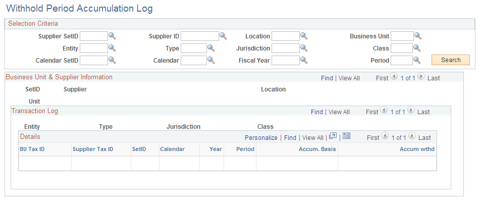

Use the Withhold Period Accumulation Log page (WTHD_PER_TOT_INQ) to review transaction logs used in period-based withholding.
Navigation:
This example illustrates the fields and controls on the Withhold Period Accumulation Log page. You can find definitions for the fields and controls later on this page.
Selection Criteria
Enter search criteria for the withholding period transactions and click the Search button.
Business Unit and Supplier Information
View the results of your search in the Business Unit & Supplier Information scroll area. This scroll area shows your results by business unit and supplier; within a business unit and supplier, you can view transactions by entity, type, jurisdiction, and class combination in the Transaction Log scroll area. Within each withholding class combination, you can view the accumulated total basis amount and withholding amount by period in the Details grid.
| Field or Control | Description |
| Accum. Basis (accumulated basis) | Displays the accumulated basis amount by business unit, supplier, withholding class combination, and period. |
| Accum wthd (accumulated withholding) | Displays the accumulated withholding amount by business unit, supplier, withholding class combination, and period. |
