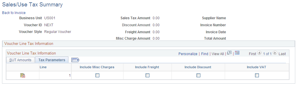

Use the Sales/Use Tax Summary page (AP_SUT_SUMM_PG) to review the sales and use tax information for all the voucher lines, and if applicable, modify tax information.
Navigation:
Click the Sales/Use Tax Summary link on the Invoice Information page.
This example illustrates the fields and controls on the Sales/Use Tax Summary page with Taxware. You can find definitions for the fields and controls later on this page.
Note: Only fields specific to Taxware and Vertex are discussed in this section. Other voucher fields are discussed in detail in "Entering and Processing Vouchers Online: General Voucher Entry Information."
Voucher Line Tax Information
Field or Control |
Description |
Click to access the Invoice Line Tax Information page to review detail tax information for this voucher line. |
Override Tax Location |
Click to access the GeoCodes and Addresses page, where you can define a new Taxware or Vertex tax location. |
Tax Destination |
Indicates the location for which a sales or use tax is applicable. This value is defined as a ship to location, but it does not have to be the same as the ship to location defined in the PeopleSoft Payables control hierarchy. |
Fields displayed when you select the More Information tab are discussed in detail in the following section.
Tax Details
These fields are display-only and represent information returned by Taxware or Vertex. These fields display the amounts that are due to each tax agency for each voucher line.
Note: For a single voucher line, up to four tax code types can be displayed: County, State, City, and District.

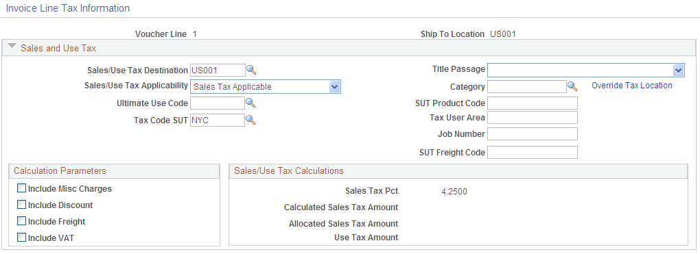

Use the Invoice Line Tax Information page (VCHR_LINE_TAX) to review and, if applicable, override tax settings for the voucher line.
Navigation:
Click the Sales/Use Tax link in the Invoice Lines group box on the Invoice Information page.
This example illustrates the fields and controls on the Invoice Line Tax Information page with Taxware. You can find definitions for the fields and controls later on this page.
The fields on this page display values that are passed to the voucher line through the PeopleSoft Payables default hierarchy. If the voucher was created by copying a purchase order, purchase order values override the PeopleSoft Payables default hierarchy, so the voucher inherits sales and uses tax data from the purchase order. However, the third-party tax application provides the tax rates used in the calculation. When you create a new voucher, all of the fields on this page can be overridden for the voucher line.
Fields Appearing For Third-Party Tax Applications Only
Additional fields appear on this page if you have installed and enabled a third-party tax application, like Taxware or Vertex.
Sales and Use Tax
Field or Control |
Description |
Title Passage |
Select Buyer Dest (buyer destination), Consignee, or Sell Origin (seller origin). These applications use this information to apply the appropriate tax calculation algorithms. |
Category |
Select a category that applies to the voucher line. This system populates this field by default from the purchase order. |
SUT Product Code, Tax User Area, Job Number, and SUT Freight Code |
Displays information that is copied from the purchase order if the voucher is created by copying a purchase order. These fields are information-only and appear on the third-party tax application register. |
Click to access the GeoCodes and Addresses page, where you can define a new Taxware or Vertex tax location. You can enter an address for any one or all four addresses to determine the applicable tax; point of order, order acceptance (Taxware only), ship to, and ship from addresses. Note: If you enter a one-time address in PeopleSoft Purchasing, that address populates this field. |
Tax Details
These are display-only fields. After you return to the Invoice Information page and save the voucher, access the Voucher Line Tax Information page again. These fields will now display the amounts that are due to each tax agency for the voucher line.
