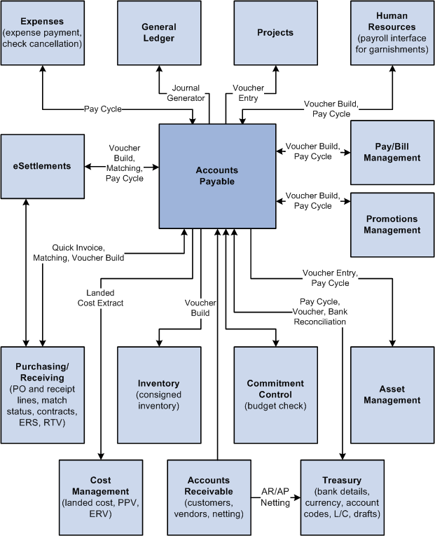

The following diagram illustrates how PeopleSoft Payables integrates with other PeopleSoft products.
Important! You should disable products that you don't have installed on the system using the Installed Products page. Disabling products that you do not have installed on the system improves performance.
