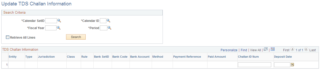

Use the Update TDS Challan Information page (WTHD_CHLN_INFO) to view and update Challan information for TDS reporting.
Navigation:
This example illustrates the fields and controls on the Update TDS Challan Information page. You can find definitions for the fields and controls later on this page.
| Field or Control | Description |
| Calendar SetID, Calendar ID, Fiscal Year, and Period | Enter calendar, fiscal year, and period search information. The system returns and displays payment details whose withholding declaration date is within the period entered in the Period field. |
| Retrieve All Lines | Select check box to retrieve all lines. The system obtains and displays all payment details regardless if a Challan ID number or date of deposit has already been entered against the payment ID. |
| Paid Amount | Displays the total of the amounts paid for all suppliers with the same payment reference. |
| Challan ID Num (Challan ID number) | Enter the Challan ID number for that payment. The system displays the Challan ID number on the TDS Certificate (APY8080). |
| Deposit Date | Enter the date the tax payment was deposited as stamped by the bank on the Challan. The system displays the deposit date on the TDS Certificate (APY8080). |

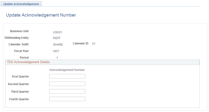

Use the Update Acknowledgement Number page (UPD_ACKNO_PG) to enter acknowledgement numbers to be printed on the TDS certificate.
Navigation:
This example illustrates the fields and controls on the Update Acknowledgement Number page. You can find definitions for the fields and controls later on this page.
| Business Unit | Displays the business unit entered on the Add a New Value page. |
| Withholding Entity | Displays the withholding entity entered on the Add a New Value page. |
| Calendar SetID | Displays the calendar SetID entered on the Add a New Value page. |
| Calendar ID | Displays the calendar ID entered on the Add a New Value page. |
| Fiscal Year | Displays the fiscal year entered on the Add a New Value page. |
| Period | Displays the period entered on the Add a New Value page. |
| First Quarter, Second Quarter, Third Quarter, and Fourth Quarter | Enter the acknowledgement number of the previous quarter's TDS return for each quarter. These are place holders for the acknowledgement numbers received from the tax department after filing the returns for first, second, third and fourth quarters respectively. The values entered here will be displayed on the TDS certificate. |
| Tax Deducted | Enter the amount of tax remitted in respect of the deductee in relevant quarter. |
| Tax Deposited | Enter the amount of tax deposited in respect of deductee in relevant quarter. |
