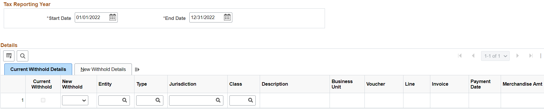

This example illustrates the fields and controls on the Withholding Invoice Line Update page (1 of 2). You can find definitions for the fields and controls later on this page.
            This example illustrates the fields and controls on the Withholding Invoice Line Update page (2 of 2). You can find definitions for the fields and controls later on this page.

Tax Reporting Year
Enter the start and end dates of the tax year for which you are reporting withholding.
Details
The Details grid lists the voucher lines returned by your search. The Current Withhold Details tab displays the original withholding information for the selected voucher lines. You can update these by entering new values on each row. If you want to update all the voucher lines to the same new withholding combination, enter the withholding combination in the Defaults group box and click the Set All Lines to Wthd button.
The New Withhold Details tab shows the updated withholding details after you have saved the page.
The following are fields that appear on the Current Withhold Details tab:
| Field or Control | Description |
| Current Withhold | Displays selected to indicate that the voucher line is currently withholdable. |
| New Withhold | Select Y for withholding applicable or N for no withholding on the voucher line. Note: You must complete the remaining line information (Entity, Type, Jurisdiction, and Class fields), regardless of whether selecting Y or N. This ensures the system correctly processes the withholding data. |
| Payment Date | Displays the voucher payment date. Vouchers must be paid before you can update voucher lines. |
