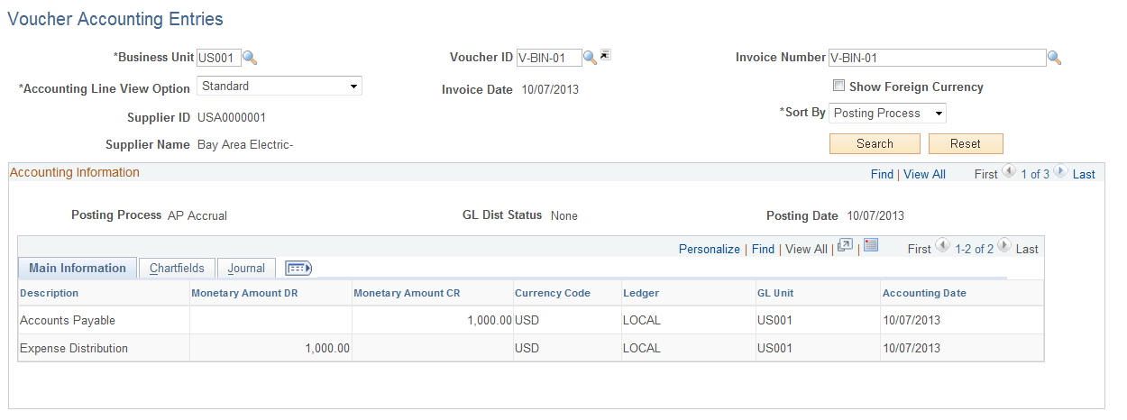

Use the Voucher Accounting Entries page (VCHR_ACTG_ENTRIES) to review the results of the Voucher Posting Application Engine process (AP_PSTVCHR).
Navigation:
Click the Accounting Entries button on the Voucher Inquiry page.
This example illustrates the fields and controls on the Voucher Accounting Entries page. You can find definitions for the fields and controls later on this page.
Note: Multiple views of this page are available by selecting the tabs in the scroll area.
Common Page Information
Field or Control |
Description |
Business Unit |
Select the business unit for the voucher whose accounting entries you want to review. You must also select a voucher ID or invoice number or the system does not return any data. |
Voucher ID |
Select the voucher ID of the voucher whose accounting entries you want to review. |
Click the Voucher Inquiry icon to access the Voucher Inquiry page and view information about this voucher. |
Invoice Number |
Select the invoice number of the voucher whose accounting entries you want to review. |
Accounting Line View Option |
Displays Standard and is the only available value if you have not enabled entry events. If you have enabled entry events, select one of the following values: Standard: The system displays nonentry event accounting entries. Supplemental: The system displays only entry event accounting entries. View Both: The system displays both entry event and nonentry event accounting entries. |
Show Foreign Currency |
Select to display the foreign currency of the transaction lines in addition to the monetary amount. |
Invoice Date |
Displays the invoice date, supplier ID, and supplier name of the voucher that your search returns. |
Sort By |
Select the option to order the voucher entries by choosing one of the following:
Accounting Information
Field or Control |
Description |
Posting Process |
Displays the posting process for the specific entry. Note: Each posting process appears on its own view in the Accounting Information region. The different views appear as view 1 of 2, view 2 of 2, and so on. To see the accrual, payment, cancel, and closure definitions, click View All, or scroll through each of these views. |
GL Dist Status (general ledger distribution status) |
Displays the PeopleSoft General Ledger distribution status. |
Main Information Tab
Select the Main Information tab.
Field or Control |
Description |
Monetary Amount DR (monetary amount debit) |
Displays the monetary amount debit associated with the PeopleSoft General Ledger business unit of the accounting entry. This field appears only if the Display Debit/Credit Amounts in Subsystems check box is selected on the User Preferences - Overall Preferences page. |
Monetary Amount CR (monetary amount credit) |
Displays the monetary amount credit associated with the PeopleSoft General Ledger business unit of the accounting entry. This field appears only if the Display Debit/Credit Amounts in Subsystems check box is selected on the User Preferences - Overall Preferences page. |
Monetary Amount |
Displays the monetary amount (debits as positive numbers and credits as negative numbers) associated with the PeopleSoft General Ledger business unit of the accounting entry. This field appears only if the Display Debit/Credit Amounts in Subsystems check box is not selected on the User Preferences - Overall Preferences page. |
Currency Code |
Displays the currency associated with the PeopleSoft General Ledger business unit of the accounting entry. |
Ledger |
Displays the general ledger and PeopleSoft General Ledger business unit to which this accounting entry has been charged. |
ChartField Tab
Select the ChartField tab.
Field or Control |
Description |
(USF) Schedule ID |
Displays schedule IDs for those associated with a payment (including cancellations, and so on). This field only appears if the federal payments option is enabled at the Installation Options level. |
Tax Authority |
Displays the tax authority code charged for the use tax liability lines. |
Entry Event |
Displays the entry event code and EE line number associated with the transaction line. These fields appear only if you have enabled entry events. |
Account |
Displays the account and other ChartFields to which this accounting entry has been charged. |
Journal Tab
Select the Journal tab.
Field or Control |
Description |
Journal ID, Line, and Journal Date |
Displays the general ledger journal ID, line number, and journal date assigned by the Journal Generator process for this accounting entry. If these fields are blank, then this accounting entry has not been journal generated. |
Doc Type (document type) |
Displays the document type, document sequence number, and document sequence date for this accounting entry. |
Budget Date |
Displays the date that the Budget Processor process uses to determine which budget period to verify. |
Budget Status |
Displays the budget status for this accounting entry. Possible values include: N (not checked): This accounting entry has not been budget checked. V (valid): This accounting entry passed budget checking. E (error): The system detected an error while running the Budget Processor process on this accounting entry. |
Primary |
Indicates whether this is the primary ledger. |

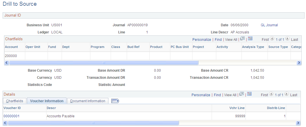

Use the Drill to Source page (AP_GL_DRILL) to review the journal detail for a general ledger journal.
You can view the journal information by journal line.
Navigation:
This example illustrates the fields and controls on the Drill to Source page. You can find definitions for the fields and controls later on this page.
Field or Control |
Description |
GL journal (general ledger journal) |
Click to view the entire journal entry to which this line belongs. |
Account |
Displays the general ledger account and other ChartFields to which this accounting entry has been charged. |
Base Amount DR (base amount debit) |
Displays the debit amount of the line in the general ledger base currency. The base currency code also appears. |
Base Amount CR (base amount credit) |
Displays the credit amount of the line in the general ledger base currency. The base currency code also appears. |
Transaction Amount DR (transaction amount debit) |
Displays the entered debit amount of the line. |
Transaction Amount CR (transaction amount credit) |
Displays the entered credit amount of the line. |
Chartfields Tab
Select the Chartfields tab.
Field or Control |
Description |
Unit |
Displays the PeopleSoft Payables business unit to which this accounting entry has been charged. |
Fund Code |
Displays the fund code and any other ChartFields to which this accounting entry has been charged. |
Voucher Information Tab
Select the Voucher Information tab.
Field or Control |
Description |
Voucher ID |
Displays the voucher ID and description of the voucher with which this journal line is associated. Click to access the Voucher Accounting Entries page, where you can view accounting details for the voucher. |
Amount |
Displays the distribution line amount of the voucher with which this journal line is associated. |
Base Amount |
Displays the amount of the distribution line with which this journal line is associated in the base currency. |
Document Information Tab
Select the Document Information tab.
Field or Control |
Description |
Document Type |
Displays the document type for this voucher line. |
Journal Code |
Displays the journal code associated with the document type for this accounting entry. |
