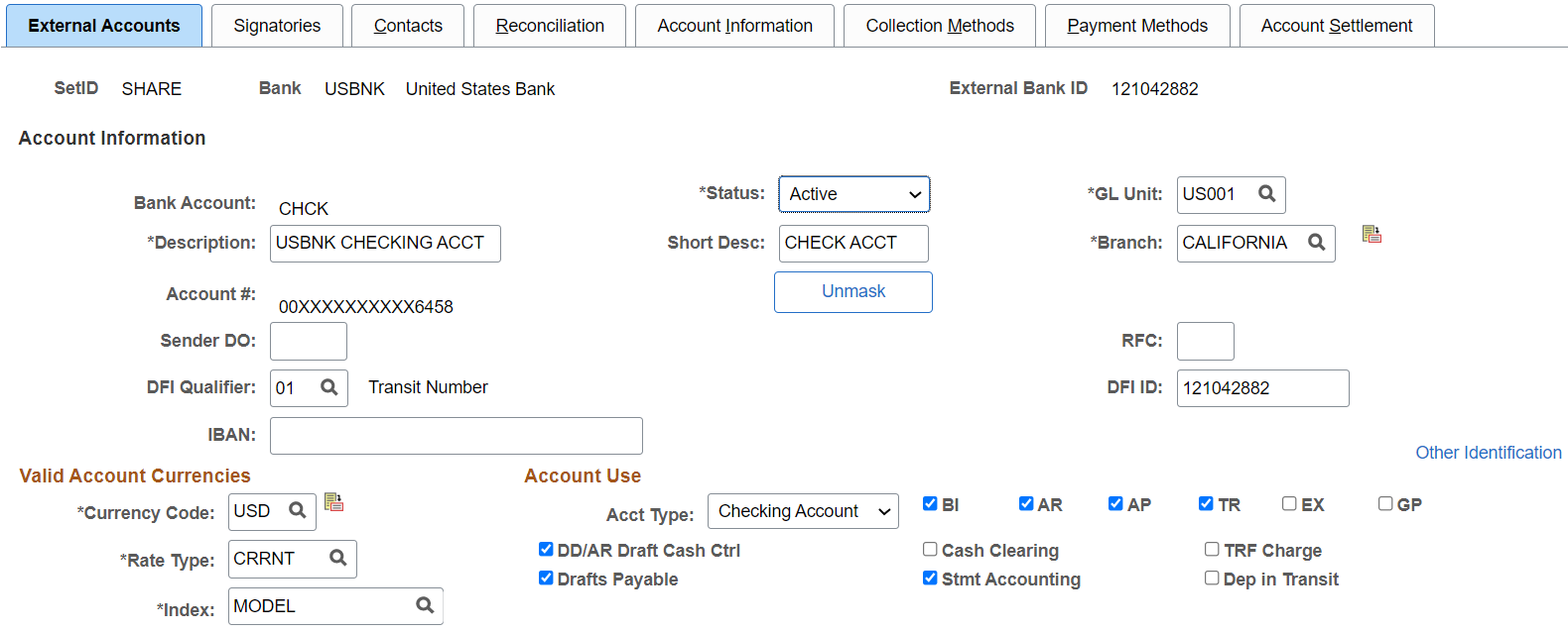

Use the External Accounts page (BANK_PNL2) to set up external accounts.
Navigation:
This example illustrates the fields and controls on the External Accounts (1 of 2) page.

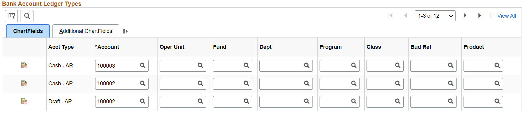

   This example illustrates the fields and controls on the External Accounts (2 of 2) page.
   To enable bank transfer charge processing:
- Select the TRF Charge check box in the Account Use group box. - The system inserts a new row in the Chartfields tab.
- Bnk Charge (bank charge) appears by default as the account type in the Acct Type (account type) field in the Chartfields tab.
- Enter the account code for suspense accounting for the bank transfer charge in the Account field in the Chartfields tab. - During payment posting, the system uses this code to hold the bank transfer charge deducted from the supplier payment.
