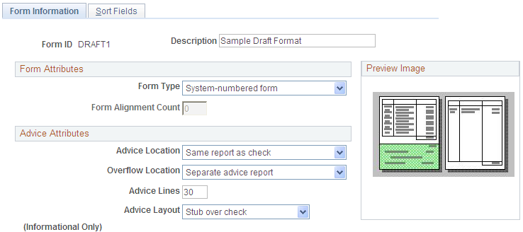

This example illustrates the fields and controls on the Form Information page. You can find definitions for the fields and controls later on this page.
Form Attributes
After you enter a form ID and description, select a form type to define during file creation if the BI Publisher layout prints check numbers and advices or only an ASCII file.
| Field or Control | Description |
| Form Type | Select the form type. Options are: ASCII file: Use for EFT or positive payment files. Pre-numbered form: The check stock has preprinted check numbers. The system does not generate check numbers, but it tracks the payment references and can warn you of any discontinuity in reference numbers. Remittance Advice only: Use for WIRE (wire transfer) reports and letters of credit. System-numbered form: The system generates check numbers to print on the payment forms. Note: You must customize the BI Publisher layout to match the form type that you specify if it differs from the form type that comes with PeopleSoft Payables. |
| Form Alignment Count | Select to align the printer head with the first row of the form so that checks and advices print correctly. You use this field with system-numbered forms only. |
Advice Attributes
| Advice Location | Select the location of the advice. Options are: No advice: No advice lines print. Same report as check: The advice prints below or above the check on the same form. Separate advice report: The advice prints in a separate job from the check. You need to load two different forms: one for the checks and one for the advices. You can also select this option to create an advice report for EFT payments. |
| Overflow Location | Select to indicate where any information that does not fit on one page prints. Options are: No advice report: No advice lines are printed. Same report as check: If more advice lines are required than the number of lines on the check form, a second check form is used for advice lines, and the check is voided. Separate advice report: A separate advice form is used for overflow. You need to load two forms: one for the checks and one for the advices. Separate reports are created. You can also select this option to create an advice form for overflow for EFT payments. |
| Advice Lines | Enter the total number of lines available for the advice. This differs depending on whether the advice is on the same report as the check or on a separate report. Note: If the first invoice has payment messages that exceed the number that you enter, voucher information prints on both the regular check and the overflow advice. The system, however, sets the payment amount to 0 on the overflow advice. Note: Advice lines only apply to checks and are not applicable to EFTs. |
| Advice Layout | Select to indicate where the check and advice are positioned on the printed page. This field is informational only. Options are: Check over stub: Position the check over the advice. Full page: Send the advice lines to a separate page from the check and a separate file. Stub over check: Position the advice over the check. |
Preview Image
As you select attributes for the form, the Preview Image group box displays a representation of the layout.
