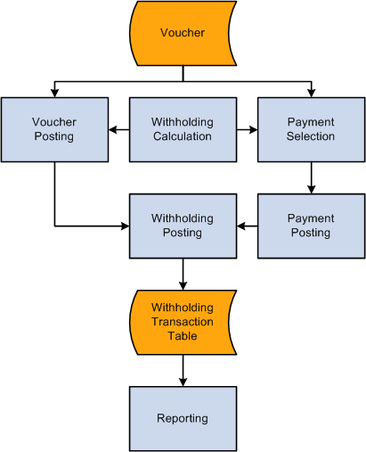

This diagram illustrates the process flow of TDS in PeopleSoft Payables.
Note: The voucher must be paid and the payment posted prior to the withholding posting.
