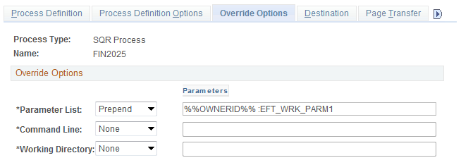

Use the Override Options page (PRCSDEFNOVRD) to enter override options for the Format EFT File process.
Navigation:
This example illustrates the fields and controls on the Override Options page. You can find definitions for the fields and controls later on this page.
If you run PeopleSoft Receivables on a DB2 database on a Windows or OS390 server, you must manually insert an owner ID parameter in the list of parameters for the process definition before you can run the Format EFT Files process.
Field or Control |
Description |
Parameters List |
Enter Prepend. |
Parameters |
In the Parameters field next to the Parameters List field, enter %%OWNERID%% :EFT_WRK_PARM1 as shown in the example above. Note that there is a space between the owner ID parameter ( %%OWNERID%%) and :EFT_WRK_PARM1. |
