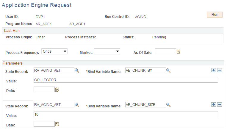

Use the Application Engine Request page (AE_REQUEST) to enter additional parameters for aging for each AR_AGE# process, such as parameters for smaller units of data or to narrow the scope of aging.
Navigation:
This example illustrates the fields and controls on the Application Engine Request page. You can find definitions for the fields and controls later on this page.
Use the State Record, Bind Variable Name, and Value fields to define exactly what data you want to age. Parameters enable you to process smaller units of data. Add as many rows as needed.

Age customers associated with a specific collector. The system processes collectors individually, marking each customer with items that are associated with a particular collector. For example, suppose that Collector A is associated with items for customers 1, 5, and 10 and that Collector B is associated with items for customers 7 and 9. The customers for Collector A (1, 5, 10) form the first chunk, and the customers for Collector B (7, 9) form the second chunk. |
State Record: RA_AGING_AET Bind Variable Name: AE_CHUNK_BY Value: COLLECTOR |
Age customers by associated collector and chunk collectors in groups of 10. |
First row: State Record: RA_AGING_AET Bind Variable Name: AE_CHUNK_BY Value: COLLECTOR Second row: State Record: RA_AGING_AET Bind Variable Name: AE_CHUNK_SIZE Value: 10 |
