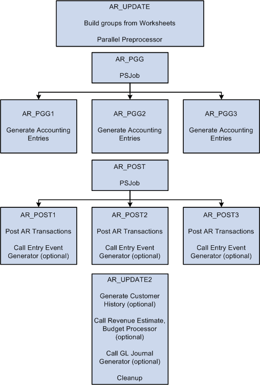

This diagram illustrates how the Receivables Update (AR_UPDATE) process works if you have three partitions. The process builds groups from worksheets and the parallel preprocessor partitions one job into three jobs to create accounting entries. AR_POST runs and posts the transactions for each job and calls the Entry Event Generator, if applicable. Receivables Update can then optionally generate customer history, call the Revenue Estimate and the Budget Processor process if Commitment Control is enabled, and call the GL Journal Generator. Finally, the Receivables Update process performs cleanup.
How the Receivables Update (AR_UPDATE) process works if you have three partitions
When you use Process Monitor to check the status of the Receivables Update process, you view the status of the ARUPDATE multiprocess job and each process within the AR_PGG and AR_POST multiprocess jobs. The system does not indicate that the ARUPDATE multiprocess job is successful until each parallel process finishes. The Job Message Log Summary page summarizes all the individual parallel-process message-log messages for the entire ARUPDATE job.

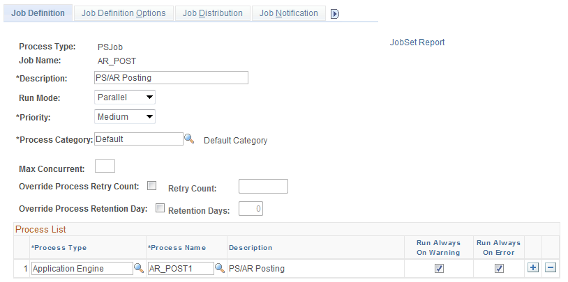

Use the Job Definition page (PRCSJOBDEFN) to add Pending Group Generator and Posting process definitions to the AR_PGG and AR_POST multiprocess jobs.
Navigation:
This example illustrates the fields and controls on the Job Definition page.
Field or Control |
Description |
Process Type and Process Name |
Select Application Engine for the type and select AR_PGG or AR_POST for each separate partition or process that you want to run. The processes must be defined in the job sequentially; for example, AR_POST1, AR_POST2, AR_POST3. A job definition of AR_POST1, AR_POST2, AR_POST5 is incorrect. If you define additional process definitions, select the name of the definitions that you added. Note: You must have the same number of rows in the process list as you enter in the Maximum Partitions field on the AR parallel Processing Options page. |
Run Mode |
Always select Parallel. |
Run Always on Warning and Run Always on Error |
You must select these check boxes. |
See also the product documentation for PeopleTools: Process Scheduler.
