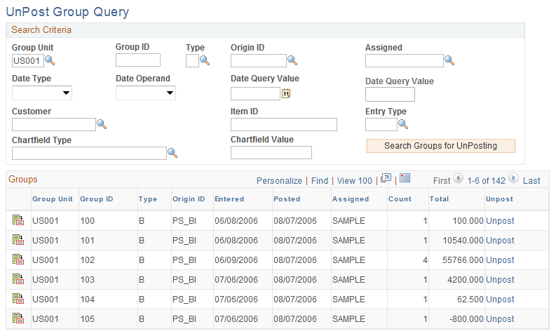

Use the UnPost Group Query page (UNPOST_QRY) to review groups that are posted based on a combination of search criteria and link to the appropriate unpost page.
Navigation:
This example illustrates the fields and controls on the UnPost Group Query page. You can find definitions for the fields and controls later on this page.
Search Criteria
Enter any combination of search criteria to retrieve the groups to unpost, and click Search Groups for Unposting.
Field or Control |
Description |
Group Unit, Group ID, Type, Origin ID, and Assigned |
Select fields from the group control record to identify groups. |
Date Type, Date Operand, and Date Query Value |
Select a type of date on the group control record. Values are: Accounting Date, Posted Date, and Entry Date. Select an operator to identify the date, such as < (less than) or Between, and enter a specific date or a date range. |
Customer, Item ID, and Entry Type |
Select a value for a customer, item ID, or entry type for the items in the group. |
Chartfield Type and Chartfield Value |
Enter the ChartField type and value to select groups that contain distribution lines for a specific ChartField value. |
Groups
The Groups grid displays the groups that match your search criteria.
Field or Control |
Description |
Click the Show Group icon to access pages to view group control information, item details, and distribution lines. |
Unpost |
Click the Unpost link to access the appropriate unpost page for the group type, where you can unpost the group. |

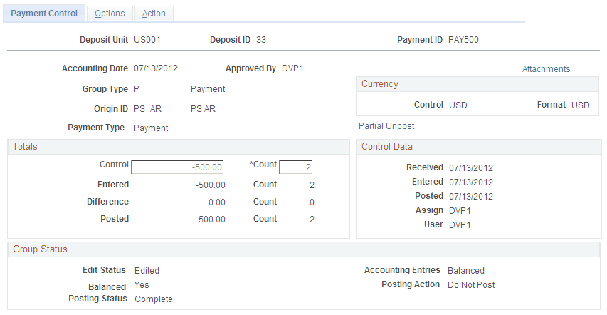

Use the Group Control, Payment Control, or Draft Control page (GROUP_ENTRY1_DSP) to review the control information, such as the group type, accounting date, group totals, and posting status.
Navigation:
Accounts Receivable, Receivables Update, Unpost Groups, Online Group, Group Control
Accounts Receivable, Receivables Update, Unpost Groups, Payment Group, Payment Control
Several other navigation paths are available for the Group Control page.
This example illustrates the fields and controls on the Payment Control page.

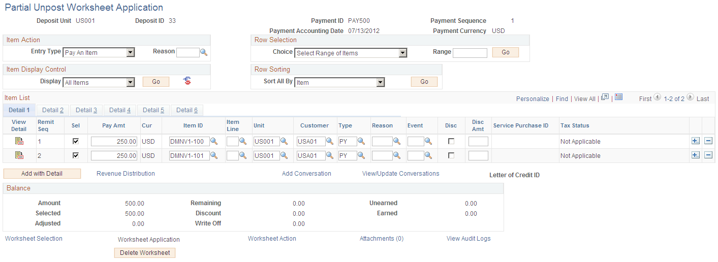

Use the Partial Unpost Worksheet Application page (PAYMENT_WS_IC) to partially unpost a payment group.
This page is accessible only through the Partial Unpost link on the Payment Group page (GROUP_ENTRY1_DSP) in the Unpost Groups component.
Navigation:
Click the Partial Unpost link on the Payment Control page.
This example illustrates the fields and controls on the Partial Unpost Worksheet Application page. You can find definitions for the fields and controls later on this page.
To partially unpost a payment in Receivables:
Navigate to the Unpost Groups - Payment Group page and select a payment group to unpost.
The payment information appears on the Payment Control page.
Click the Partial Unpost link to transfer to the Partial Unpost Worksheet Application page. The items from the original payment group will appear selected on this page and the Remaining payment balance will be zero. All other balances will be appropriately initiated.
Reapply the payment as needed by deselecting or deleting Items from the original payment group, effectively keeping them unposted. The worksheet balance amounts will reflect the actions taken, and the user must then reapply the payment amounts to balance the new payment group.
Post both groups.

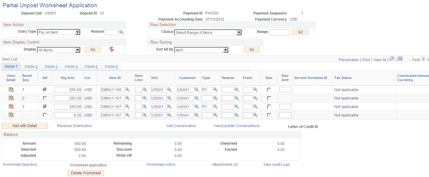

Partial Unpost Scenario
In this scenario, the user does the following:
Deselects Item DMNV1-101 from the original Payment Group, leaving a Remaining balance of 250.00 USD.
Creates a new row and selects Item DMNV1-107 for 258.00 USD.
Changes the Pay Amt to 250.00 USD in the new row for Item DMNV1-107 to balance the worksheet.
The split-item row for Item DMNV1-107 shows a Pay Amt of 8.00 USD, and the Remaining balance is 0.00 USD.
This example illustrates the fields and controls on the Partial Unpost Worksheet Application page, where the remaining balance is 0.00.
Saves and clicks the Worksheet Action link to go to the Action page, where you can set the group to post.
Only one group ID will display on the Action page, and the Partial Post group is the next group ID.
