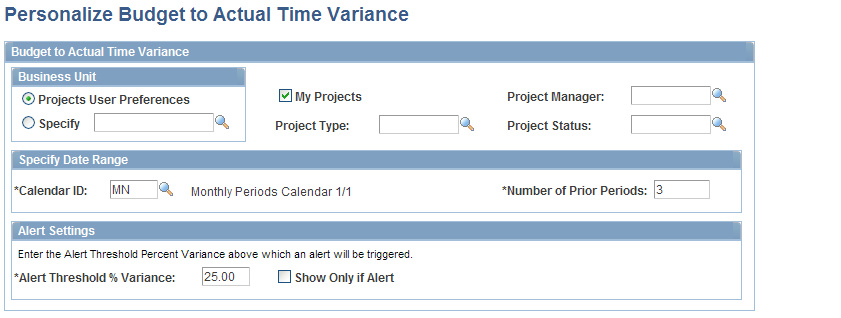

Use the Personalize Budget to Actual Time Variance page (PC_PE_BATV_PRS) to define default data for calculating and displaying the Budget to Actual Time OTA.
Navigation:
Click the Budget to Actual Time Variance link on the ESA Portal Pack Pagelet Default Administration page.
Click the Personalize icon for this OTA on the Personalize Operational Threshold Alerts page.
This example illustrates the fields and controls on the Personalize Budget to Actual Time Variance page.
For this OTA, the unit of measure is converted to hours, or the row is excluded from the calculation if the unit of measure cannot be converted.
The Budget to Actual Time description appears on the Operational Threshold Alert pagelet as a link that can access the Budget Summary component. Budget to Actual Time can also appear as a bar chart on the Operational Threshold Chart pagelet.

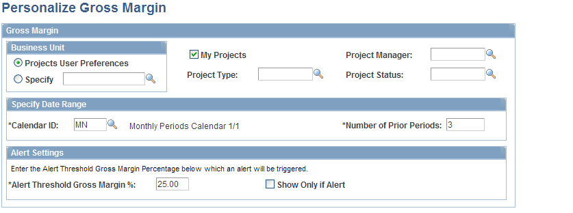

Use the Personalize Gross Margin page (PC_PE_GRMG_PRS) to define default data for calculating and displaying the Gross Margin OTA.
Navigation:
Click the Gross Margin link on the ESA Portal Pack Pagelet Default Administration page.
This example illustrates the fields and controls on the Personalize Gross Margin page.
For this OTA, the alert threshold triggers a red alert visual indicator to appear on the Operational Threshold Alert pagelet if the gross margin is less than the threshold. A green visual indicator appears on the Operational Threshold Alert pagelet if the gross margin equals or is greater than the threshold, indicating that the margin is acceptable.

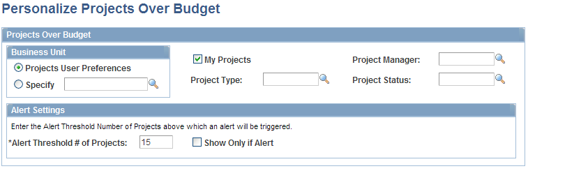

Use the Personalize Projects Over Budget page (PC_PE_OVER_PRS) to define default data for calculating and displaying the Projects Over Budget OTA.
Navigation:
Click the Projects Over Budget link on the ESA Portal Pack Pagelet Default Administration page.
This example illustrates the fields and controls on the Personalize Projects Over Budget page.
For this OTA, the alert threshold represents the number of projects that trigger a red alert visual indicator to appear on the Operational Threshold Alert pagelet if the number of projects over budget is greater than the threshold. A green visual indicator appears on the Operational Threshold Alert pagelet if the number of projects over budget is less than the threshold, indicating that the number of projects is acceptable.
