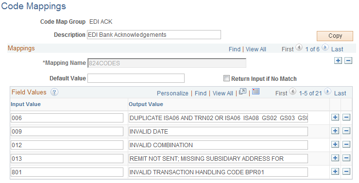

Code Mappings enable you to define the mappings between external system codes with their equivalent internal PeopleSoft codes. For example, PeopleSoft stores 03 account types as checking accounts, and the required code for the EDI 820 bank statement layout is DA for deposit account. Code mappings are used to map these hard-coded field values to each other so that the transformation program component can use them. This allows a single transformation program to be used across multiple banks even though the program may need different code mappings.
Code mappings are most useful for fields that may change for every bank. Bank statement processing uses mappings for three fields: bank statement codes, reconciliation or "recon" codes, and statement activity types. For example, a bank identifies certain miscellaneous fees with the numeric code 564. If you define it as a Bank Fee, you can assign the input value of 564 to the output value of BKFEE. Other banks may use a different value to identify bank fee.
See Defining Statement Activities.
There are three levels to the code mapping data-structure hierarchy:
- Code Map Group: The highest level, this is a container for all the fields for a given code map set. For instance, a code map group could represent all the code mappings for a particular bank.
- Code Map Header: The second level, this represents a particular field for which the transformation Application Engine obtains the code map.
- Code Map Items: The items contain all the possible input and output values for a particular field or header.

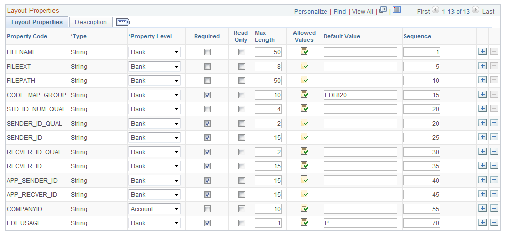

Use the Layout Catalog page (PMT_FORMAT_CATLOG) to create new or modify existing bank statement, payment, and payment acknowledgment layouts by defining transformation processing details, payment methods, parameters, and properties.
Navigation:
This example illustrates the fields and controls on the Layout Catalog page (1 of 2). You can find definitions for the fields and controls later on this page.
This example illustrates the fields and controls on the Layout Catalog page (2 of 2). You can find definitions for the fields and controls later on this page.
Define the file layouts, output type, and integration options that a particular bank supports. The catalog stores information about the layout, the program name containing the logic to generate or process the layout, and additional required setup or processing parameters that the layout requires.
If the bank does not support any of the delivered layouts or has a modified version of a delivered layout, you can create a new layout or edit a delivered layout. After a new or modified layout is added to the Layout Catalog, it is available for use in the system.
If you are adding new layouts or editing existing layouts for an organization's payment processing requirements, you must first create the new layout before you can continue this setup procedure. Follow the procedures to create a new layout that are outlined in the sections Defining Payment Grouping Rules, Defining Code Mappings for Banks Statements, Payments, and Payment Acknowledgments, and Creating Payment Layouts. Then add the new layout to the Layout Catalog.

Layout Properties
Layout Properties are information that is needed by a transformation program to successfully create and process a layout. A layout property can be anything, but generally is either a data value that is needed by a layout that is not captured in the system or a processing flag that is needed by a transformation program. These properties are defined at design time, bound with values at setup time, and available to the transformation program at runtime. The values for these defined properties are captured at setup time for every bank.
For example, the layout property SENDER_ID, which is used by the EDI 820 payment layout, identifies the ID of the party that is sending the file. No field is defined in Financial Gateway to store this value, yet this layout requires the property at runtime. Adding SENDER_ID to the layout properties allows this value to be set up for every bank. At runtime, this value is available to the transformation program to be included in the 820 layout.
| Field or Control | Description |
| Property Code | Displays the name of the layout field. For the SEPA_CT_03 layout, the following details are available:
 Important! If you specify a default, file-extension value for the FILEEXT property code, you must enter a period before the file extension. For example, you enter .TXT, not TXT. Note: A specific layout property FS_MAP_ID is available for configuration when the selected value in the Transformation Program Type field is Data Mapper . The property level for this property is set at the bank level. The property value is identified on the Bank Integration Layouts page, and it should match the Map Definition value setup in the Data Export Import Utility. |
| Type | Specify the property code data type: Date, Number, String, Time, or Yes/No. |
| Property Level | This determines where the property will be set up: bank, account, or system level. For payment layouts, this also determines where in the PAYMENT_DISPATCH IP this value is available to the transform program. System and bank level properties are available in the PMT_HEADER_PROP record. Account level properties are available in the PMT_BATCH_PROP record. For payment files, the layout property values are included in the PAYMENT_DISPATCH IP for use in transformation programs at runtime. The records PMT_HEADER_PROP and PMT_BATCH_PROP contain these values. If you are creating a new transformation program and need to capture some setup information, such as company TAXID, a layout property would be added to the Layout Catalog. It would be set up at bank of account level. You can then use this information in the PAYMENT_DISPATCH message of the transformation program. |
| Required | Select to indicate that this property code is required. |
| Read Only | Select to make this property code a display-only value. This type is good for system settings that need to be captured, but do not vary by bank. |
| Max Length (maximum length) | Enter the maximum character length. At setup time, the entered value is validated to ensure that it is not longer than the maximum length and is the type specified (for example, string, number, yes/no, and so on). |
    | Click the Allowed Values icon to access the Allowable Format Properties page (PMT_FORMAT_VALUES), where you can select the type of list option to apply as the allowed format property. Select one of these list options:
| Default Value | Enter a property-code, default value. You can override this value when defining integration layouts for a bank or account. |
| Sequence | Enter sequence numbers to prioritize the property codes. Properties with lower numbers will be displayed first at setup time. During the transformation process, the system processes property codes from the lowest to the highest value. |
Use the Code Mappings page (TR_CODE_MAPPINGS) to define input and output values for mappings of a selected code map group.
Navigation:
This example illustrates the fields and controls on the Code Mappings page. You can find definitions for the fields and controls later on this page.
This page enables you to define the mapping between external bank codes with their equivalent internal PeopleSoft codes for both bank statement and bank payment processing.
Bank statement processing uses mappings for three fields: Bank Statement Codes, Reconciliation Codes, and Statement Activity Types.
For example, a financial organization identifies certain miscellaneous fees with the numeric code 564. If you define a statement activity type of Bank Fee (BNKFEE), you can assign the input value of 564 to the output value of BNKFEE.
| Copy | Click to create a new mapping group based on the parameters of the current, code map group. |
| Mapping Name | Enter a mapping name. |
| Default Value | Enter a default value for the specific map. The system uses this defined default value if it cannot match the existing mapping input value and you do not select the Return Input if No Match check box. |
| Return Input if No Match | Select to indicate that the system should use the input value as the map-to value if the system cannot match the existing mapping-input value with a defined input value. |
| Field Values | Enter the Input Values and the corresponding Output Values to which they are to be mapped. For bank statement processing, the Input Values are the external bank codes, and the Output Values are the PeopleSoft codes. For bank payments, the Input Values are the PeopleSoft codes, and the Output Values are the external bank codes. |
