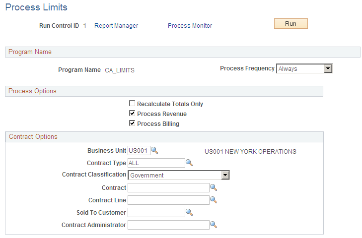

Use the Process Limits page (RUN_CA_LMT) to run the Limits process as a standalone process using specific parameters such as business unit, contract, contract line, or contract type.
Optionally, run this process to recalculate totals only.

This example illustrates the fields and controls on the Process Limits page. You can find definitions for the fields and controls later on this page.
Field or Control |
Description |
Recalculate Totals Only |
Select to update limit totals after making manual adjustments to invoices in PeopleSoft Billing. This option updates your limit totals that are displayed on the Review and Manage Limits component (CA_LMT_MGMT) and on the Limits report. |
Process Revenue |
Select to run the Limits process for revenue limits only. Note: This field will always be visible irrespective of the Separate As Incurred Billing and Revenue check box on the contract. The Limits process will check the status of Separate As Incurred Billing and Revenue for each contract and process the applicable rows accordingly. |
Process Billing |
Select to run the Limits process for billing only. |
Contract Options
Use the fields in this group box to limit the population of contracts included in the process. Filter by PeopleSoft Contracts business unit, contract type, contract classification, contract, contract line, sold to customer, or contract administrator. If you leave all fields blank, the process picks up all available transaction activity in PeopleSoft Contracts.
