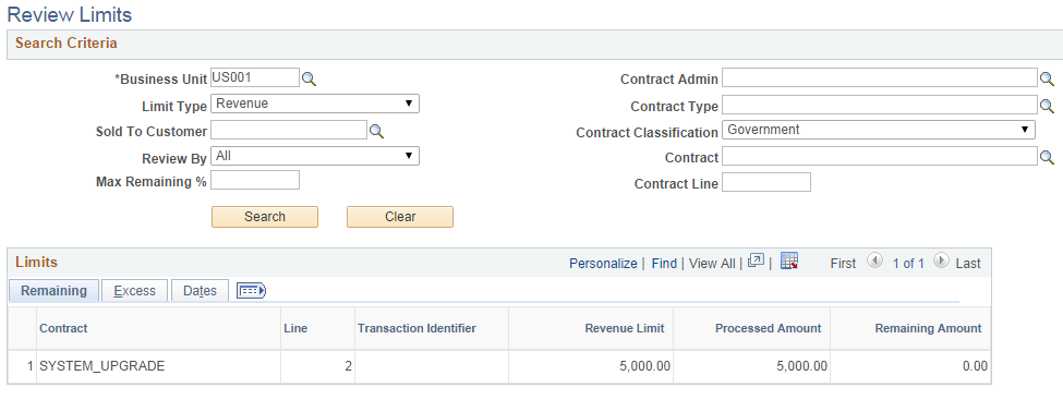

Use the Review Limits page (CA_LMT_REVIEW) to review contract line limit and transaction limit information for specified contract lines.
Navigation:
Customer Contracts, Determine Price and Terms, Contract Terms, Contract Amounts and click the Review Limits link on the Contract Amounts page.
Review Limits page - Remaining tab
This example illustrates the fields and controls on the Review Limits page - Excess tab. You can find definitions for the fields and controls later on this page.

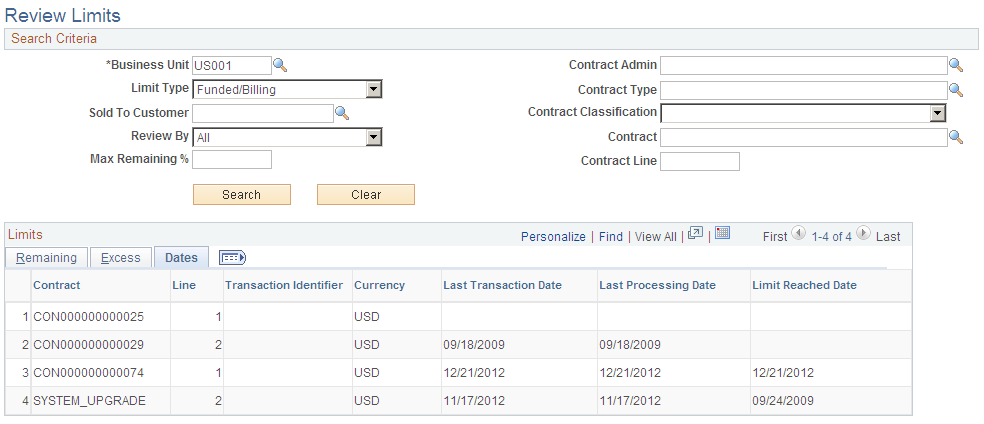

This example illustrates the fields and controls on the Review Limits page: Dates tab. You can find definitions for the fields and controls later on this page.
Search Criteria
Use the fields in the Search Criteria group box to filter results. If you leave fields blank, the search returns all limits for all Active contract lines within your system. At a minimum, you must enter the Business Unit, Limit Type, and Review By fields to perform a search request. Click the Search button to carry out a search based on the search criteria that you entered. Search results appear in the Limits scroll area. Amounts appear in the contract currency.
Note: Fee limits do not appear on this page. Fee limits for rate-based contract lines associated with a fee type (cost-plus) can be viewed on the Billing and Revenue Worksheet pages and Contract Amounts pages for the contract line.
Field or Control |
Description |
Limit Type |
Select a limit type. If you leave this field blank, Funded/Billing is the default value for this field. Limit type values include:
Review By |
Select the Review By criteria. Review By values include:
Max Remaining % (maximum remaining percentage) |
Enter a maximum remaining amount percentage to restrict the results to only those contract lines with that limit amount percentage or less remaining. If you set the Review By field to Remaining, you must enter a field value greater than zero and less than 100. If you set the Review By field to Excess or All, the Max Remaining % field must be set to zero to retrieve the desired results. |

Dates Tab
Select the Dates tab.
Field or Control |
Description |
Currency |
Displays the contract currency. If a Project Costing transaction is processed in a different currency from the contract currency, the transaction is converted to the contract currency by the Pricing Engine and then applied to the limit in the contract currency. |
Last Transaction Date |
Displays the transaction date for the most recent transaction applied against the limit for the contract line. |
Last Processing Date |
Displays the date that the Limits process was last run for this contract line. |
Limit Reached Date |
Displays the date that the limit amount is reached. If limits are increased by means of amendment processing such that all over-the-limit transactions can pass limit checking, or all excess amounts can be reclaimed (when summary limits are used for government contracts), then this field is deselected during the next run of the Limits process with the Recalculate Total Only check box deselected. |

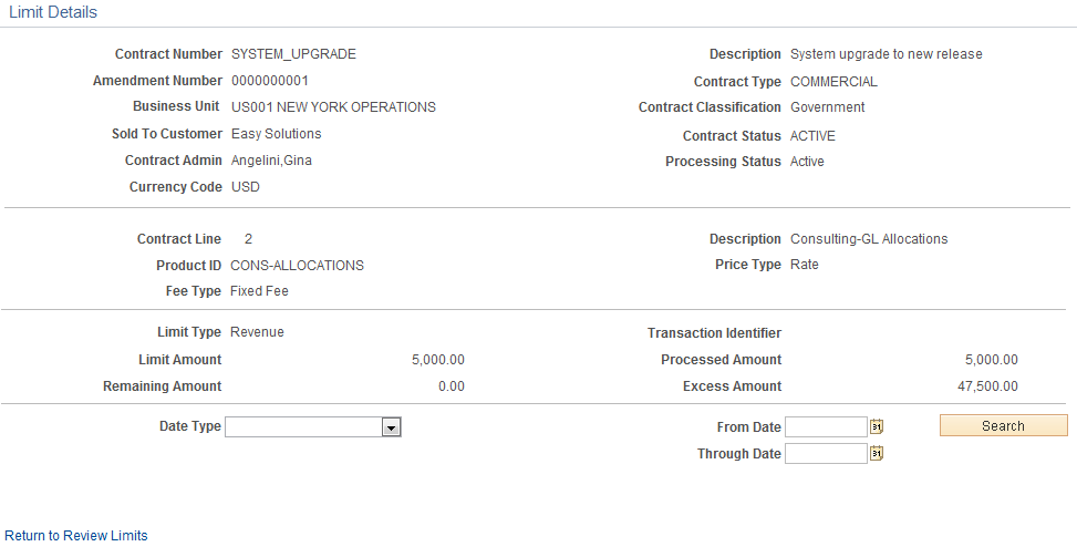

Use the Limit Details page (CA_LMT_DETAILS) to review the details of over-the-limit transactions.
Navigation:
Click the value in the Excess Amount column of the Review Limits page.
This example illustrates the fields and controls on the Limit Details Page. You can find definitions for the fields and controls later on this page.
Field or Control |
Description |
Date Type |
Select a date type to have the system retrieve all over-the-limit billing and revenue transactions within the specified date range. Date type values include:
From Date and Through Date |
Select specific from and through dates to have the system retrieve all over-the-limit transactions within the specified date range. |
Search |
Click to retrieve the over-the-limit transactions that meet your date search criteria. |
Transaction Date |
Displays the transaction date of the original cost transaction from the feeder subsystem. |
Accounting Date |
Displays the accounting date of the original cost transaction from the feeder subsystem. |
Foreign Amount |
Displays the over the limit (OTL) , excess (negative), or reclaimed (when summary limits are used for government contracts) amount for the transaction in the original cost transaction currency. |
Projects Business Unit Amount |
Displays the transaction OTL, excess (negative), or reclaimed (when summary limits are used for government contracts) amount in the PeopleSoft Project Costing business unit base currency. |
