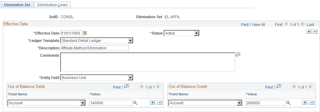

Use the Elimination Set page (ELIMINATION_SET1) to define parameters for the elimination.
Navigation:
This example illustrates the fields and controls on the Elimination Set page. You can find definitions for the fields and controls later on this page.
Field or Control |
Description |
Ledger Template |
Select the ledger template that is used by the ledgers in your consolidation. If you specify a Summary Ledger template as the ledger template, the system displays the Ledger field, where you enter the summary ledger name. The system also displays a detail link; click it to access the Summary Ledger Definition page. |
Description |
Identifies the elimination for prompt lists. |
Comments |
Describe what the elimination set does. This field is particularly useful for documenting each set in a complex consolidation. |
Field or Control |
Description |
Entity Field |
Select the field on which you are consolidating. This is the field on which you have previously structured your consolidation and on which you have built your consolidation tree. It is usually the business unit. However, if you have setup your system to use other fields, such as Operating Unit or Department for the business entity and are tracking interunit transactions among these entities, you use Operating Unit or Department as the Entity Field. |
Out of Balance Debit and Out of Balance Credit
If the activity within a given elimination set does not net to zero, PeopleSoft General Ledger directs the out-of-balance amount to the Out of Balance field values that you specify on this page.
Field or Control |
Description |
Field Name |
Specify special ChartFields for the out-of-balance amounts. For example, you can enter a department for both the debit and credit field name in addition to an account Value. For summary ledger templates, the Field Name prompt lists all the ChartFields for the summary ledger template, and the Value prompt is based on how the summary ledger is defined. |
