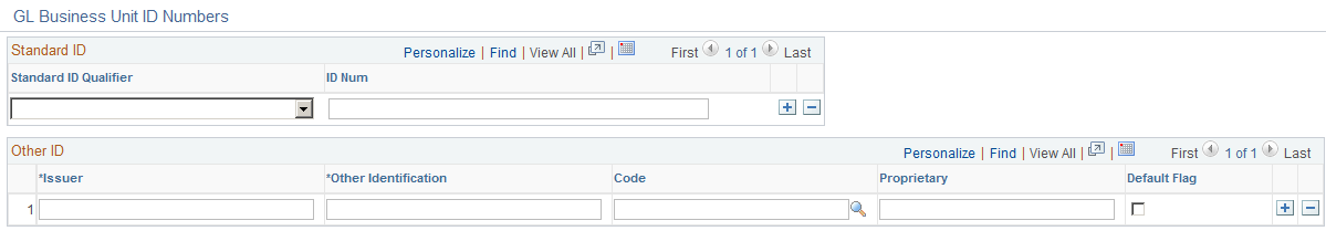

Use the Business Unit ID Numbers page (BU_ID_NBRS_GL_SEC) to enter the ID for the reporting entity for a business unit.
Navigation:
Click the Business Unit ID Numbers link on the General Ledger Definition - Definition page.
This example illustrates the fields and controls on the GL Business Unit ID Numbers. You can find definitions for the fields and controls later on this page.
Field or Control |
Description |
Standard ID Qualifier |
Select the qualifier for the type of reporting entity. Use BEI Identifier to populate the ISO and SEPA formats. |
ID Num (ID number) |
Enter the ID number for the reporting entity for the business unit. |
Other Identification |
Provide Other ID information for the business unit entity that will be used in ISO and SEPA formats. Other ID information consists of Issuer, Identification, and either an ISO Code List or a Proprietary Scheme Name under which the identification was issued. You must designate one issuer as the default that will be populated on the ISO and SEPA format. |
