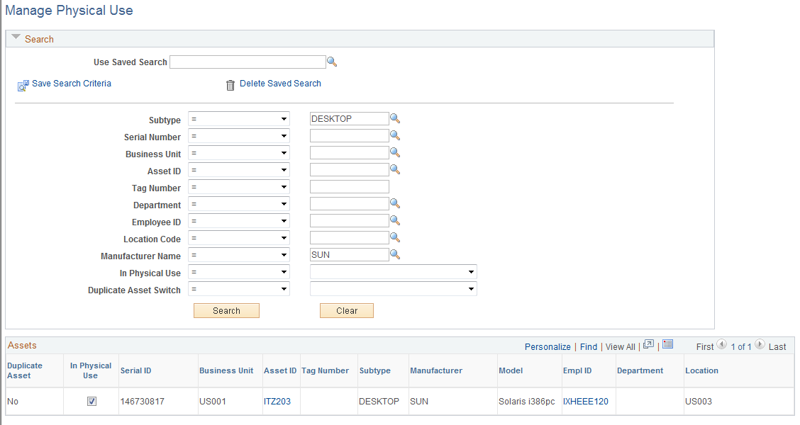

Use the Manage Physical Use page (IT_PHY_USE) to .
Navigation:
This page can be accessed from the portal menu or from the Exists column (duplicate serial ID) link on the Manage Exceptions page.
This example illustrates the fields and controls on the Manage Physical Use page. You can find definitions for the fields and controls later on this page.
Select desired criteria and click the Search button to retrieve the assets within the Assets result grid.
Field or Control |
Description |
Duplicate Asset |
This field indicates whether an asset has a duplicate serial ID. |
In Physical Use |
Select or deselect this check box to resolve discrepancies between the asset repository and discovery. Changes made to this page are incorporated in the main asset record within the asset repository. When the page displays multiple rows of the same serial Id (duplicate assets) with the In Physical Use check box selected, deselect the duplicate(s) so that only one asset/serial Id remains in physical use. If the page displays multiple duplicate serial Ids and none are in physical use, select the one asset that is considered to be in physical use. This asset will be used in the Compare Asset Repository process. An edit exists to check that the serial ID of the asset that is either put in or taken out of In Physical Use has only one asset designated as In Physical Use. This edit will not occur unless one of those two assets (in the pair) has had its record modified; in other words, the In Physical Use value has changed. |

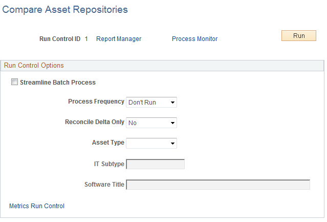

Use the Compare Asset Repositories page (IT_RECON_RUN) to compare discovered data with asset repository data.
Navigation:
This example illustrates the fields and controls on the Compare Asset Repositories page. You can find definitions for the fields and controls later on this page.
Field or Control |
Description |
Streamline Batch Process |
Select this option to automatically create the run control for the Generate Metrics process. If you select this option, a dialog box gives you the choice of creating the run controls automatically or manually. If the run control for Generate Metrics is created automatically, it is created with the same Run Control ID shown previously: ABC. Conversely, if you choose to create the Generate Metrics run control manually, then for the Streamline Batch Process to work, the new run control for Metrics must have the same Run Control ID. |
Process Frequency |
Select the frequency for the process to be run. Select Always to allow the process to run every time it is called. Select Once to allow it to be run one time only, after which it resets to Don't, preventing restarts. |
Reconcile Delta Only |
Select this option to reconcile delta discoveries only. During the comparison process, assets that have been processed are marked. When reconcile delta discoveries is selected, the comparison processes only the changes that were made in the Asset Repository. If changes have been made to assets or if mapping errors have been corrected, this option cleans up those items without doing a complete reconciliation. When Reconcile Delta Only is selected, the comparison process only processes rows that have never been processed before. When this option is not selected, the system processes both sets of rows; those that have been processed before as well as those never processed. |
Asset Type |
You can select IT Hardware or IT Software to narrow the reconciliation. If you select IT Hardware, the IT Subtype field is available. If you select IT Software, the Software Title field is available. If the Asset Type is left blank, the Compare Asset Repositories process reconciles all available IT assets in the cache tables. It evaluates both hardware and software-related business rules, which can greatly affect performance. When the Asset Type is IT Hardware and the IT Subtype is left blank, then all hardware assets are processed. All active business rules are applied to determine exceptions. When an IT subtype is specified, then all active business rules are applied to hardware assets belonging to the specified IT subtype. Software rows are not evaluated for possible exceptions. When the Asset Type is IT Software and Software Title is left blank, then all software rows that require permission or authorization to install are evaluated for exceptions. When a Software Title is specified, then all rows belonging to the specified software title are evaluated. When the asset type is IT Software, business rules for hardware attributes such as model, manufacturer, and so on are not evaluated. |
IT Subtype |
Indicate which IT subtypes are to be processed. If you do not select a specific IT subtype, all hardware assets are processed. |
Software Title |
Indicate which software title should be processed. If you do not select a specific title, all software titles are processed. |

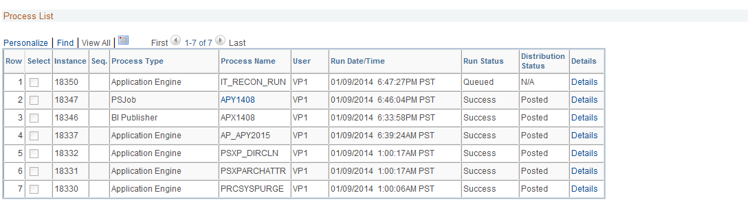

After running the Compare Asset Repositories process (IT_RECON_RUN), you can review the message log in the Process Monitor to see what discrepancies were found :
This example illustrates the fields and controls on the IT_RECON_RUN Message Log..

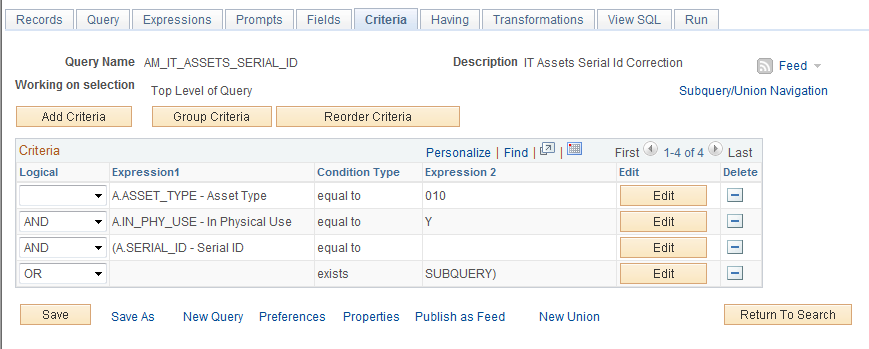

PeopleSoft IT Asset Management delivers two queries for comparison to the Asset Repository:
AM_IT_ASSETS_SERIAL_ID - (IT Assets Serial Id Correction) - This delivered query detects duplicate and blank Serial IDs.

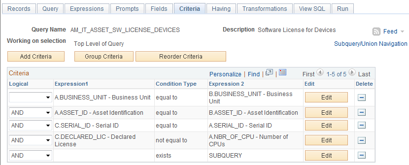

AM_IT_ASSET_SW_LICENSE_DEVICES - (Software License for Devices) - This delivered query reports those assets that have a CPU number that is different than the declared licenses.

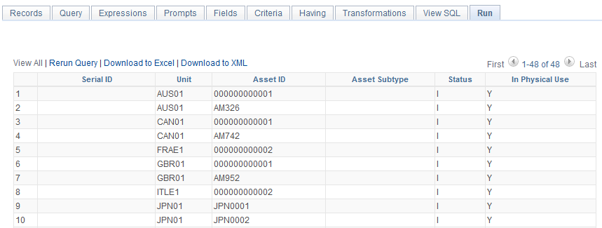

Serial ID Query
Access the AM_IT_ASSETS_SERIAL_ID query from the Query Manager page
This example illustrates the fields and controls on the AM_IT_ASSETS_SERIAL_ID query.
This example illustrates the fields and controls on the AM_IT_ASSETS_SERIAL_ID query result set.
In addition to the alert provided on the Manage Exceptions page for duplicate serial IDs, you can run the query and review the detail results to verify duplicate or blank Serial IDs.

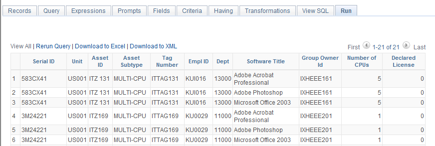

This example illustrates the fields and controls on the AM_IT_ASSET_SW_LICENSE_DEVICES query.
This example illustrates the fields and controls on the AM_IT_ASSET_SW_LICENSE_DEVICES query result set.
