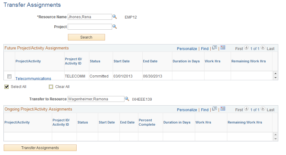

Use the Transfer Assignments page (RS_TRNSFR_ASSGNMNT) to transfer assignments from one resource to another.

This example illustrates the fields and controls on the Transfer Assignments page. You can find definitions for the fields and controls later on this page.
Field or Control |
Description |
Resource Name |
Enter the name of the resource from which you want to transfer an assignment. You must enter a resource name to search for assignments. The resource must be a named resource on a project. |
PC Business Unit (project costing business unit) |
Optionally, enter a business unit to filter the project assignments to that business unit for the resource. This field appears only if the resource that you enter in the Resource Name field has assignments in more than one business unit. |
Project |
Optionally, enter the project to view project assignments for the resource. |
Search |
Click to display the assignments in the Future Project/Activity Assignments grid that have been assigned to the resource that you entered in the Resource Name field. |
Select the resource's project and activity assignments that you want to transfer. Selecting a project automatically selects the project's future-dated activity assignments. You cannot select ongoing projects (the check box is not available for selection) but you can select future activity assignments on ongoing projects. |
Project/Activity |
Displays the project or activity description. The project and activity descriptions appear as links. Click a <project description> to access the Resources page for that project in a new browser window on which you can view and update details for the project team. Click an <activity description> to access the Resources By Activity page for that activity in a new browser window on which you can view and update details for the activity schedule. |
Status |
Displays status values from the Resources page only on project assignment rows. |
Start Date and End Date |
Displays the earliest start date and latest end date of project assignments on project rows. The start date and end date of activities appear on activity rows. |
Duration in Days |
Displays the activity duration. |
Work Hrs (work hours) |
Displays the value from the Work column on the Resources by Activity page. |
Remaining Work Hrs (remaining work hours) |
Displays the value from the Remaining Work column on the Resources by Activity page. |
Click to select or deselect all of the available rows in the Future Project/Activity Assignments grid. |
Transfer to Resource |
Enter a generic or named resource to which you want to transfer the assignments. For named resources, the system prompts for employee IDs from the Personal Data (PERSONAL_DATA) table. |
View Resource Schedule |
Click to transfer to the Monthly Schedule page for the resource in the Transfer to Resource field. This link is visible only if the resource is a PeopleSoft Resource Management-managed resource. |
Transfer Assignments |
Click to transfer the assignments from the Transfer From resource to the Transfer To resource. When you click this button, the system transfers you to the Transfer Assignments Confirmation page. |

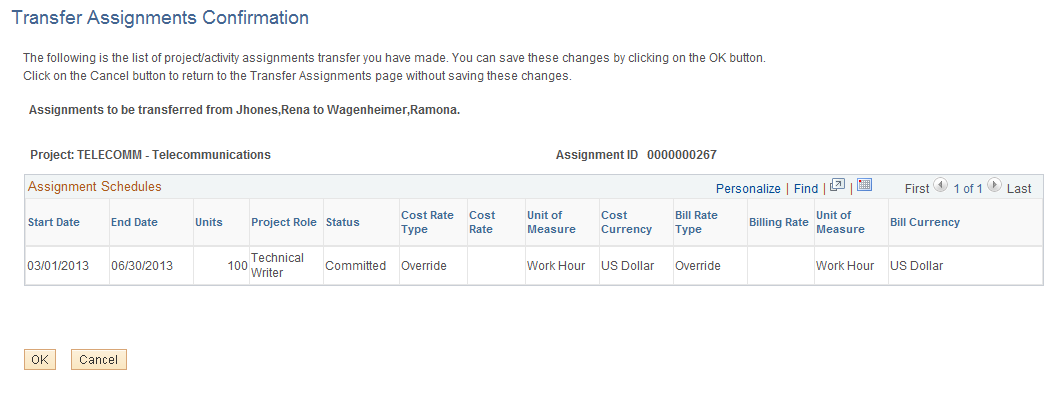

Use the Transfer Assignments Confirmation page (RS_TRNSASSGN_CONFM) to review the changes that the system will make as a result of the assignment transfer and confirm that you want to make the assignment transfer from one resource to another.
Navigation:
Click the Transfer Assignment button on the Transfer Assignments page.
This example illustrates the fields and controls on the Transfer Assignments Confirmation page. You can find definitions for the fields and controls later on this page.
Review and verify the list of assignments that the system will transfer when you click OK. If you do not want to transfer all of the assignments that are in the grid, click Cancel.
Field or Control |
Description |
Displays the assignment schedule start and end dates from the Resource detail page. |
Units |
Displays the units percentage from the Assignment Schedule grid on the Resource detail page. |
Project Role |
Displays the project role from the Assignment Schedule grid on the Resource detail page. |
Status |
Displays the value from the Resource Status column on the Resources page. However, if the Transfer From resource's status is Committed, PeopleSoft Resource Management Assignment Approval workflow is initiated, the Transfer To resource is a PeopleSoft Resource Management-managed resource, and the user is not the manager of the Transfer To resource, the system sets the status to Pending Approval and initiates the PeopleSoft Resource Management Assignment Approval workflow. If the user is the manager of the Transfer To resource, then the value is Committed. |
Cost Rate Type and Bill Rate Type |
Displays the cost and bill rate types from the Resources page. If the Transfer To resource is not already on the project, the system sets the cost and bill rate types for the Transfer To resource the same as that of the Transfer From resource. Situations exist in which this is not possible, for example:
In these situations, the system sets the rate type to the default rate type for the Transferred To resource type (named resource or generic resource) that is defined on the Program Management Options page. See Establishing PeopleSoft Program Management Business Unit Options. |
Cost Rate and Billing Rate |
Displays the cost and bill rates from the Resources page. If the Transfer To resource is not already on the project, the system sets the cost rate and bill rate based on the Transfer From resource's cost rate type and bill rate type. If the cost or bill rate type is Custom, then the system sets the cost and bill rates of the Transfer To resource to the same value as the Transfer From resource. |
OK |
Click this button to access the Update Confirmation page and view the assignment transfer confirmation and any errors that occurred during the transfer. |
