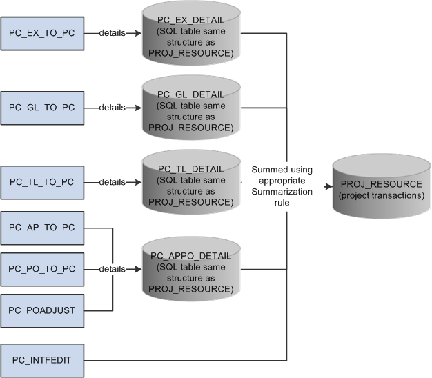

This diagram illustrates the process flow of the PeopleSoft Expenses, Time and Labor, General Ledger, and Third-Party interface processes:
This diagram illustrates that each application engine process for the corresponding feeder application, sends detailed information to the corresponding detail table. If summarization is being used (the application check box is selected in the Summarization Options section on the Installation Options – Project Costing Integrations page), then the detailed data is summarized and then added to the Project Costing transaction table (PROJ_RESOURCE).
Application Engine Process |
Detail Table |
PC_EX_TO_PC |
PC_EX_DETAIL |
PC_GL_TO_PC |
PC_GL_DETAIL |
PC_TL_TO_PC |
PC_TL_DETAIL |
PC_AP_TO_PC, PC_PO_TO_PC, and PC_POADJUST |
PC_APPO_DETAIL |
PC_INTFEDIT |
This process loads detail directly to PROJ_RESOURCE |

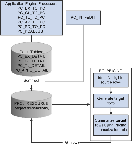

The Pricing Summary Process
When the Pricing process (PC_PRICING) runs, the process takes transactions from the project transaction table (PROJ_RESOURCE) and identifies source rows that are eligible for pricing. The process then generates target rows and looks for a pricing summarization template. If a pricing summarization template is found, the process uses the pricing summarization rule to summarize the data, create target rows, and update the project transaction table (PROJ_RESOURCE).

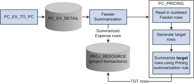

This diagram illustrates the process flow of the Project Costing pricing summarization process when pricing is called separately from the feeder interface process.
This diagram illustrates the process flow of the Project Costing pricing summarization process when the Pricing process is called with an individual feeder interface process.
Note: The Pricing Options group box, on the Project Costing Options page, determines if the Pricing process runs directly from the feeder interface processes.
