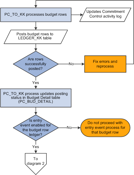

The following diagram shows a high-level process flow of using entry events in project budgeting, which begins after the Project Costing to Commitment Control process successfully posts budget rows to the Commitment Control ledger data table (LEDGER_KK), part 1:

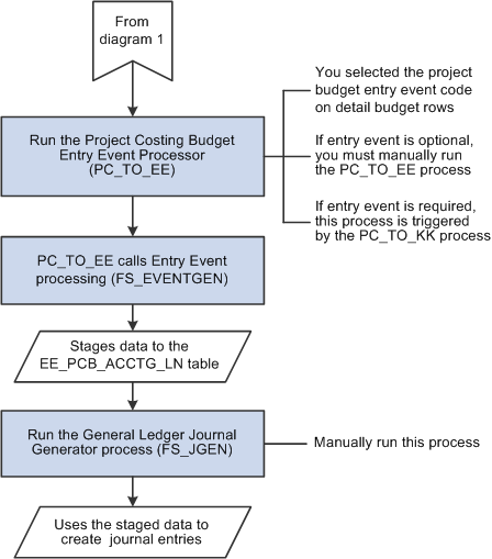

The following diagram shows a high-level process flow of using entry events in project budgeting, which begins after the Project Costing to Commitment Control process successfully posts budget rows to the Commitment Control ledger data table (LEDGER_KK), part 2:

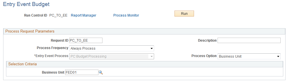

Use the Entry Event Budget page (PST_EE_RUN_REQUEST) to run the Project Costing Budget Entry Event Processor to generate standard accounting entries based on the entry event code on the project budget.
Navigation:
This example illustrates the fields and controls on the Entry Event Budget page. You can find definitions for the fields and controls later on this page.
Enter a request ID and description, and select the process frequency.
Select from these process options and enter the criteria that the system uses to select transactions to process:

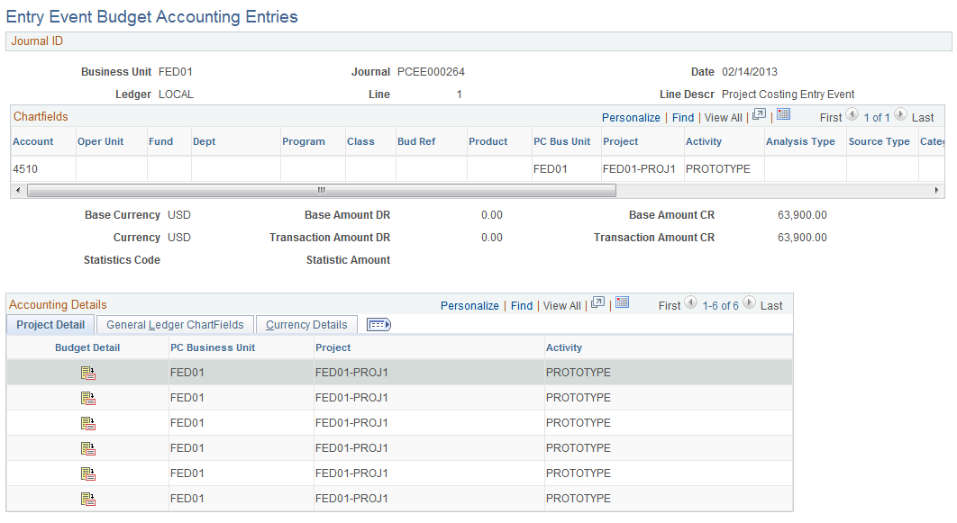

Use the Entry Event Budget Accounting Entries page (EE_PCBUD_DRILL) to drill into PeopleSoft Project Costing source data from a journal entry.
Navigation:
This example illustrates the fields and controls on the Entry Event Budget Accounting Entries page. You can find definitions for the fields and controls later on this page.
Enter the business unit on the Entry Event Budget Drill Down search page and optionally search for a journal by journal ID, date, GL journal line number, and ledger. The Entry Event Budget Accounting Entries page appears for you to view a list of accounting entries for the journal ID. Only transactions that are created by the Project Costing Budget Entry Event Processor appear on this page.
