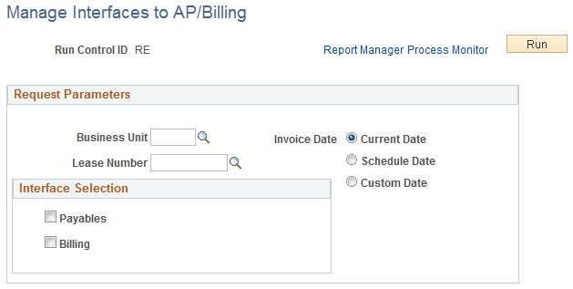

Use the Manage Interfaces to AP/Billing page (RUN_TXN_INTFC ) to run to generate transactions to PeopleSoft Billing to create sales invoices to the tenants.
Navigation:
This example illustrates the fields and controls on the Manage Interfaces to AP/Billing page. You can find definitions for the fields and controls later on this page.
Field or Control |
Description |
Business Unit |
Enter a business unit to generate transactions that are specific to that business unit. |
Lease Number |
Enter a lease number to generate transactions for that lease. You must enter a business unit before you can enter a lease number. |
Invoice Date |
Select an option from the following:
Note: The invoice date selected here overrides the invoice date specified on the Processing Payments page if the date varies on both the pages. |
Interface Selection
Field or Control |
Description |
Payables |
Select to send all payables transactions for the business unit and lease number parameters to the staging table. If you leave both fields blank, the system sends all approved transactions for payables to the PeopleSoft Payables staging table. |
Billing |
Select to send all billing transactions for the business unit and lease number parameters to the staging table. If you leave both fields blank, the system sends all approved transactions for receivables to the Billing staging table. |
