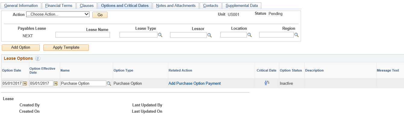

Use the Options and Critical Dates page (RE_LS_OPTIONS) to displays the list of options and critical dates associated with a lease.

This example illustrates the fields and controls on the Options and Critical Dates Page. You can find definitions for the fields and controls later on this page.
Field or Control |
Description |
Add Option |
Click to add new lease options and define critical date details. Note: Add Option is available only in Pending Lease and in Amendment. |
Apply Template |
Click to select one or more templates to apply to the lease. When you select and apply a critical date template, the critical dates that are contained in the selected template are assigned to the lease. The existing assigned critical dates are not overwritten. |
Lease Options
The lease options grid displays existing options and critical dates that you have established at the business unit level or added to this lease.
Field or Control |
Description |
Option Date |
Displays the date that this option expires. This date is critical when a decision needs to be made or an action needs to be taken for that option. For example, you can set up a lease option for availability of additional space and you have the first right to that space. Setting up the option with the critical date reminds you that an action needs to take place on or before the specified date. |
Option Type |
Displays the type based on the option selected on the Options and SAR configuration page. |
Click the Critical Date icon to access the Options and Critical Dates - Critical Date Detail page on which you can view or edit the details of the critical date and specify the notification schedule and recipient list. |
Option Status |
Displays the status of the option. The values are: Inactive: The critical date schedule for the option is inactive; no notification will be sent. Active: Critical date notifications are processed when you run the critical date notification process. The lease options becomes active after you enable notifications on the Options and Critical Dates - Critical Date Detail page. Expired: The option date is passed, notifications will not be sent. |
Enabled |
Indicates whether the schedule that is defined by the critical date has been enabled. The system enables the option after it validates the schedule and recipient details. The system sends notifications only for active critical dates that are enabled and have one or more recipients with valid email addresses. |

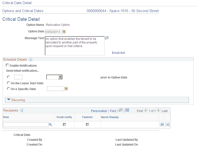

Use the Critical Date Detail page (RE_SAR_CRDT_DTL) to enter schedule details and recipient information for critical date notifications.
Navigation:
Click the Critical Date icon on the Options and Critical Dates page.
This example illustrates the fields and controls on the Options and Critical Dates - Critical Date Detail page. You can find definitions for the fields and controls later on this page.
Click the Add Options button.
Field or Control |
Description |
Option Name |
Select the option for which you want to establish for a critical date. This is a required field. |
Option Date |
Enter the date that this option occurs or expires. The date that you enter must occur on or after the current date and cannot occur before the lease commencement date. This is a required field. |
Message Text |
Enter the text to insert into the email notification that is defined in the Lease Option Setup page. Note: You must include the %MSG% tag in the mail template of the option in order to have this text appear in the generated email. |
Email Text |
Click to display a sample of the email content that is generated and sent to recipients. You cannot edit the email text from this view. The email text is specified when you define the lease option during setup. You may, however, tailor the Message Text field to customize the message for this specific lease. |
Schedule Details
Field or Control |
Description |
Enable Notifications |
Select to enable email notifications. |
Send initial notification |
Select the option for sending initial notifications. Critical date notifications operate within a date range. The options in this group determine the timing of the start date. Options include: Prior to Option Date: Use this option to begin notifications on a specific number of days, months or years before the option date. On the Lease Start Date: Use this option to begin sending notifications from the lease Commencement Date field that is specified in the General Information page for lease maintenance. On a Specific Date: Use this option to begin sending notifications on a specific date. The date that you select must be prior to the option date. |
