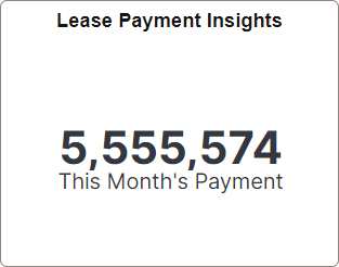

Lease Payment Insights

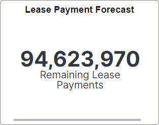

Lease Payment Forecast

This example illustrates the Lease Payment Insights tile
This example illustrates the Lease Payment Forecast tile
