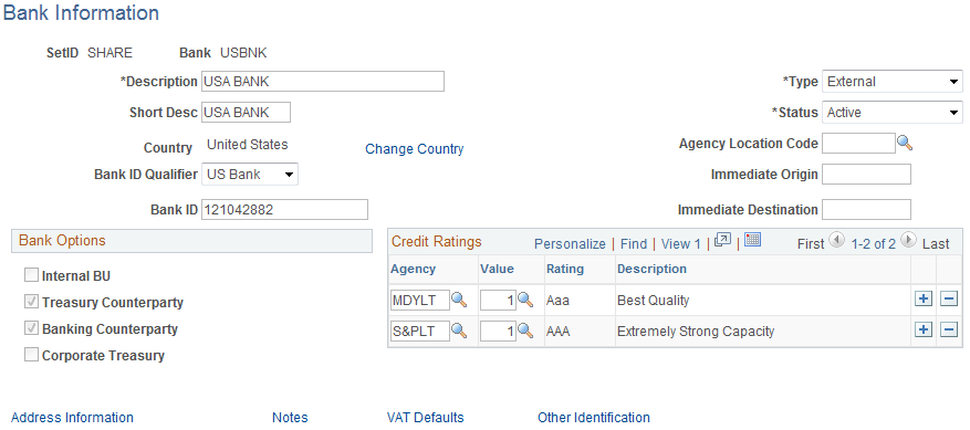

Use the Bank Information page (BANK_PNL1) to define each bank and its general characteristics.
Navigation:
This example illustrates the fields and controls on the Bank Information page. You can find definitions for the fields and controls later on this page.
Field or Control |
Description |
Type |
Select a bank type. Options are: External: A bank or counterparty that exists separately from your organization. Most banks and brokerage firms are in this category. External banks are those you conduct business with outside of your organization, such as banking partners, brokers, issuers, and guarantors. You can associate external banks with a reconciliation method, cutoff times, settlement instructions, supplier banks, customer banks, and employee banks. Internal: A bank or counterparty that is part of your organization (for example, a central treasury, a subsidiary company, or an operating division). Netting: A Receivables or Payables counterparty with whom you have established a netting contract to roll up transactions and thus decrease the overall number of transactions between parties. Origin: A Receivables or Billing entity that holds funds until they are transferred to a bank. Typically, this is an organization with which you have a lock-box banking arrangement. |
(USF) Agency Location Code |
To reconcile U.S. federal government schedule ID payments, select the U.S. Treasury Disbursing Office that is disbursing payments for Treasury Schedules (known as SF-1166 Voucher and Schedule of Payments). This option applies only to banks with a default currency of USD. The General Ledger report GLSF224P uses the Agency Location Code (ALC) when reporting General Ledger, Receivables, and Payables cash activity to the federal government. |
Bank ID Qualifier |
Select a bank qualifier, if one is defined for the bank's country. The system uses the bank qualifier to validate values when you create accounts for the bank. |
Bank ID |
Enter a bank ID, to use electronic banking. This is the code by which the bank identifies itself. The code is contained in the electronic statement and edited according to rules driven by the bank ID qualifier. This field is accessible only for external and origin bank types. |
Immediate Origin and Immediate Destination |
Enter origin and destination routing codes for electronic transfers. Obtain the codes from your bank. |
Important! You cannot define the same Bank ID for different SetIDs. System returns an error message for duplicate Bank IDs. You can override the restriction by changing the message severity to Warning on the Message Catalog page.
