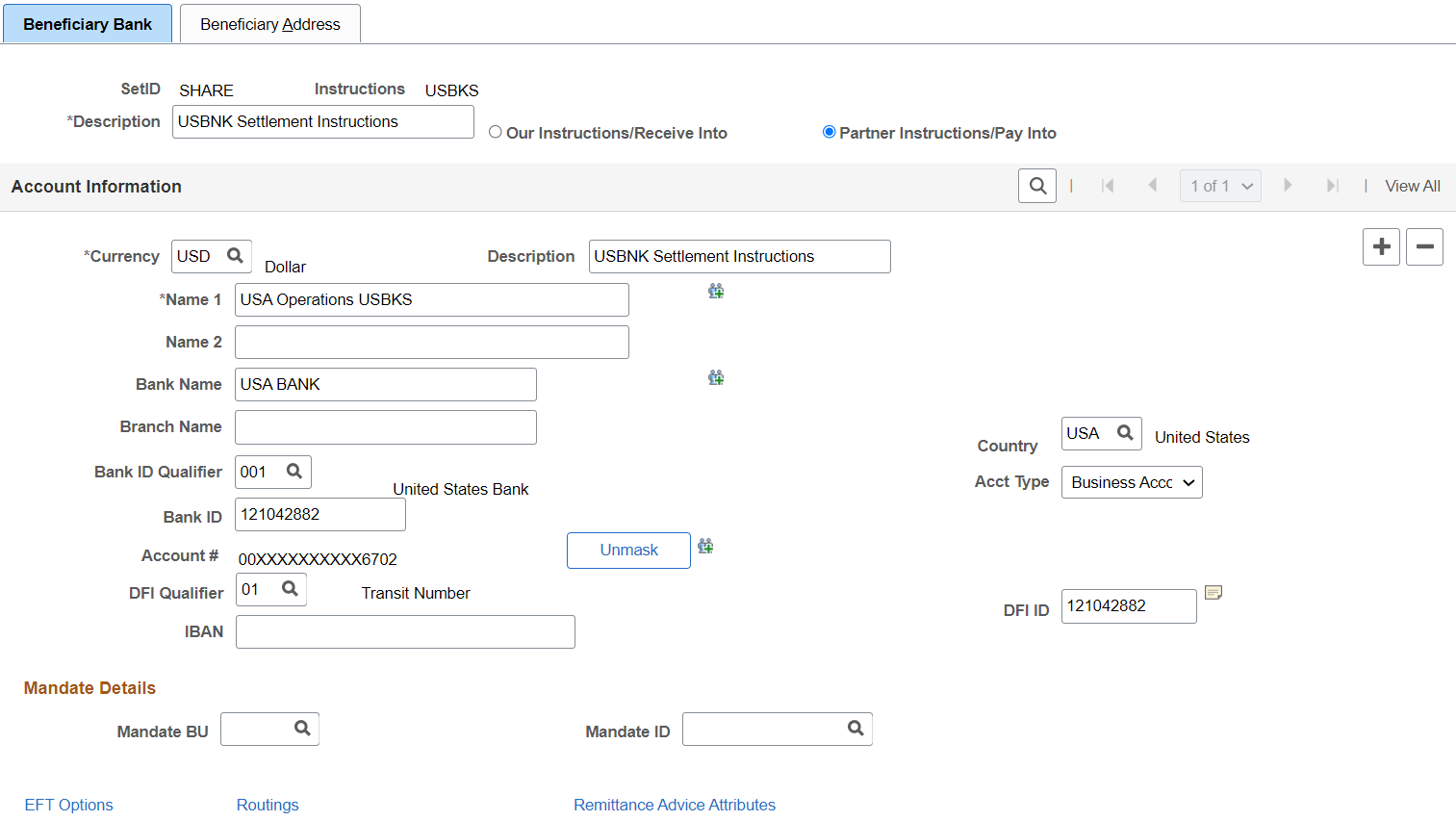

Use the Beneficiary Bank page (STL_INSTRUCTION) to create settlement instructions for use by Treasury Management.
Associate the instructions with appropriate accounts or counterparties.
Navigation:
This example illustrates the fields and controls on the Beneficiary Bank page. You can find definitions for the fields and controls later on this page.
Field or Control |
Description |
Our Instructions/Receive Into |
Select if these instructions dictate receipt of funds from a counterparty. Generally, information entered here matches external bank account information already defined in the PeopleSoft system (on the External Accounts page). |
Partner Instructions/Pay Into |
Select if these instructions dictate payment of funds to a counterparty. Generally, information entered here enables electronic payment to an account not defined in the PeopleSoft system. |
Click the Identification icon next to the Name1, Bank, or Bank Account fields to access the Identification Information page (TR_OTHID_SP), where you can where you can provide other identification for Name1, Bank, and/or Bank Account values, respectively. This icon appears only on Beneficiary Bank pages for a Partner Instructions/Pay Into settlement type. |
Account # |
Enter bank account number. If you set up bank account encryption, account numbers are masked when you save the page. For more information about bank account number encryption and the National Automated Clearing House Association (NACHA) data security requirements, see Understanding Bank Account Encryption and Setting Up Bank Account Encryption. |
Unmask |
Select to unmask the bank account number and IBAN. |
Account Information
Complete the fields to identify the bank that receives funds when using these settlement instructions:
If the Partner Instructions/Pay Into radio button is selected, the bank account that you describe here is the counterparty's bank account into which you're transferring funds.
Because bank accounts are defined by currency, you must insert additional rows for each currency used for fund settlement.
If the Our Instructions/Receive Into radio button is selected, the bank account that you describe here is your bank account for receiving funds in the referenced currency.
Field or Control |
Description |
Currency |
Select the currency. Oracle recommends that you set up settlement instructions for each currency defined for the bank account. |
Name 1 and Name 2 |
Enter the beneficiary names, if required. |
Bank ID Qualifier |
Select an ID to enable the bank information to be edited online. For certain bank ID qualifiers, you must specify a check digit. |
IBAN Digit |
Enter the check digit and click View IBAN. If the system validates the check digit, the IBAN (international bank account number) for this account appears next to the View IBAN button, and the system stores it on a record. This field and the View IBAN button appear only if the IBAN Enterable field is not selected on the IBAN Formats page. For the specified settlement instructions, define the account's IBAN for transmittal with other settlement information. |
IBAN |
Enter the IBAN (international bank account number). This field appears only if the IBAN Enterable field is selected on the IBAN Formats page. |
DFI Qualifier and DFI ID |
Select the DFI qualifier (depository financial institution qualifier) and enter the associated DFI ID to identify the bank using its DFI ID. If you use intermediary routings, this bank represents the final bank into which funds are transferred. The DFI qualifier indicates the format—the number of characters and numerics—that is used in the bank's DFI ID. Each type has a specific number of digits that you can enter: Transit Number: Enter exactly nine numerics, plus check digit calculation. Swift ID: Enter 8 or 11 characters; positions 5 and 6 must be a valid two-character country code. CHIPS ID: Enter three or four numerics for a CHIPS ID (CHIPS Participant ID). CHIPS UID (CHIPS universal identification number): Enter six numerics for a CHIPS UID. Canadian Bank Branch/Institute: No validation. Mutually Defined: No validation. |
