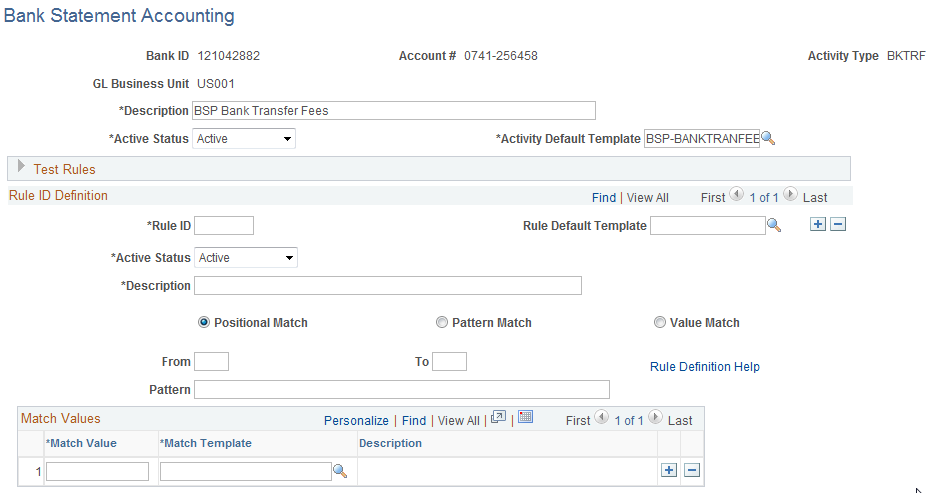

Use the Bank Statement Accounting page (BNK_BSAC_HDR) to define bank statement accounting match rules.
The system searches the bank statement addenda for the transactional text that you define and automatically assigns a default accounting template to the transaction.
Navigation:
This example illustrates the fields and controls on the Bank Statement Accounting page. You can find definitions for the fields and controls later on this page.
The system derives the Description and Activity Default Template field information from the selected statement activity type.
You can set Activity Status options at both the overall header level and the individual rule level.

Enter sample addenda text to test your defined rule. For example, to define a pattern match (and assuming all required fields are defined):
Test Rule button |
Click to test if the rule is behaving as desired. This process applies the defined rule(s) against data in the Sample Addenda field. By doing so, this tests whether the defined BSA rule assigns the appropriate accounting template. |
Rule ID |
Enter a unique identification code for the match rule, up to seven characters long. This ID is used by the system to order the rules that are applied to the addenda. In this manner, you can dictate which rules should be applied before others. |
Rule Default Template |
Select a default accounting template for defined positional and pattern rules (not applicable for Value Match option). For exceptions that match the defined rule, the system automatically creates corresponding system-side accounting entries per the default accounting template parameters. |
Help Information |
Click to view information on defining match values. |
Positional Match |
Select to match data based on the positions that are entered in the From and Through fields. |
Pattern Match |
Select to match the entire masked string value that is adjacent to the entered Pattern. |
Value Match |
Select to match the values that are entered in the Match Value field and also specify a Match Template value. The system searches by whole word only to find an exact match. This applies to any string of characters that you enter in the Match Value field. For example, the system:
If you define a value that cannot be matched, the system uses the Activity Default Template value. |
