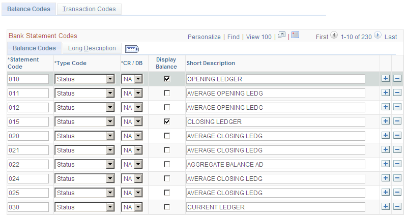

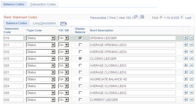

Use the Balance Codes page (BSP_BAL_CODES) to define bank statement code information.
Also select up to three statement balance codes to appear on online inquiry pages.
Navigation:
This example illustrates the fields and controls on the Balance Codes page. You can find definitions for the fields and controls later on this page.
Balance codes are assigned to each balance line and determine how the reconciliation process handles them. Each balance entry that is received electronically or entered manually should be assigned a balance code.
Field or Control  |
Description  |
Statement Code  |
 Enter a three-digit statement code that is to be defined.  |
Type Code  |
 Indicate if the code is a Status or Summary code.  |
CR / DB (credit/debit)  |
 Indicate if the code is a CR (credit) or DB (debit), or select NA (not applicable) if this categorization does not apply.  |
Display Balance  |
 Select this check box to indicate that the balance is a favorite balance. The system automatically displays the favorite balances on certain pages, such as the Bank Balance Inquiry page. You can select up to three different balances to be displayed. You can edit these selections at any time.  |

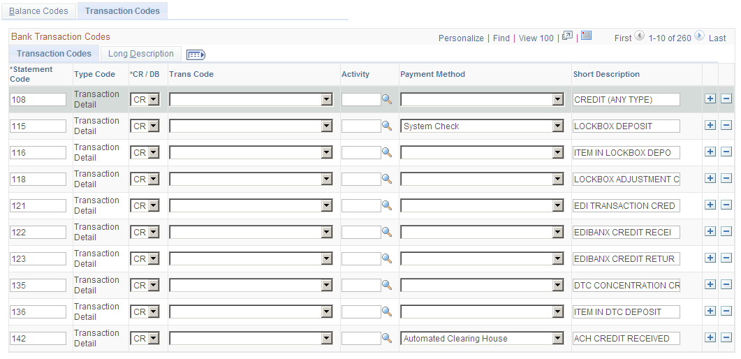

Use the Transaction Codes page (BSP_TXN_CODES) to define bank statement transaction code information, such as activity type and payment method.
Navigation:
This example illustrates the fields and controls on the Transaction Codes page. You can find definitions for the fields and controls later on this page.
The system assigns transaction codes to each bank statement transaction line during electronic load or manual entry. The transaction code determines how the reconciliation processes the specific line item.
Field or Control  |
Description  |
Trans Code (transaction code)  |
 Identifies the type of transaction in a bank statement. Select from: Automated Clearing House Bank Adjustments Bill of Exchange - Disburse Bill of Order - Disburse Check Deposits Direct Debit Direct Debit - Disburse Drafts Electronic Funds Transfer Fee Expense Funding Receipt General Transaction Interest Expense Manual Check Miscellaneous Transaction Payment Stop Pay (stop payment) Trade Receipt Voided Payment Wire - Disbursement Wire - Incoming  |
Activity  |
 Select a statement activity type.  |
Payment Method  |
 Identifies the payment method that is specified for a transaction code. Select from: Automated Clearing House Direct Debit Draft - Customer EFT Draft - Customer Initiated Draft - Supplier Initiated Electronic Funds Transfer Giro - EFT (Giro-electronic funds transfer) Giro - Manual Letter of Credit Manual Check System Check Wire Transfer Payment Card  |
