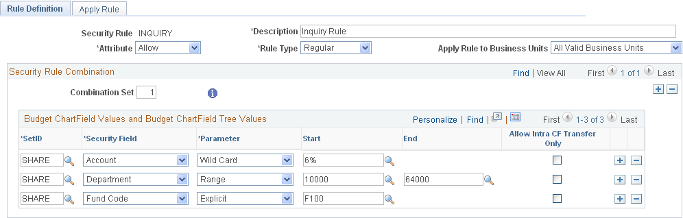

Use the Budget Security - Rule Definition page (KSEC_RULE_ENTRY) to specify the key ChartField values and business units that define the budgets included in a security rule.
Navigation:
This example illustrates the fields and controls on the Rule Definition page. You can find definitions for the fields and controls later on this page.

Each combination set represents a budget or range of budgets (depending on the parameters you use to select ChartField values). When you add a new combination set, the system generates a sequential combination set number. When more than one ChartField is being secured in combination with other ChartFields, establish combination sets for a rule as opposed to defining individual rules for each ChartField value or range of ChartField values. To control for multiple ChartFields that are interrelated, create a rule using multiple ChartField Combination Sets. For example, if a user is to have access to the following ChartFields for these specific values:
Create the following ChartField Combination Sets for one rule:

Select a key ChartField for the budget or budgets you want to include in the combination set. You specify each ChartField and its value or values on a separate row. The ChartField must be on the list of security fields defined on the Security Field Setup page. This list also includes budget period, ledger group, and ledger. Observe the following rules when adding security ChartFields:

Select the parameter the system is to use to identify valid ChartField values:

Allow Intra CF Transfer Only (allow intra ChartField transfer only) |
Select to limit budget transfers to budgets that share the same value for the ChartField. For example, if the combination set includes all of the Accounts in the range 100001 to 100010 and you have selected Allow Intra CF Transfer Only for Account, then users assigned to the security rule will be able to transfer budget amounts only between budgets that share in common Account 100001, and between budgets that share in common Account 100002, and so forth. Users are not able to transfer budget amounts between budget for account 100001 and budget for account 100002. When you are using a combination of ChartFields, set up the combination in the same rule. For example, create rule #1 to allow a user to transfer budgets ranging from accounts 100001 to account 100002 but only for department 1234. You create the ability to transfer and the restriction for department 1234 all in rule #1. Do not create a rule for the Account ChartField, then a rule for the Department ChartField. A separate rule for each of the ChartField values or ranges of values, even if run sequentially, results in user access to unintended budgets. This is because system logic allows update for any row that passes any one rule. Note: Use only for security rules that apply to the Budget Transfer security event and use only with a rule attribute of Allow. |
