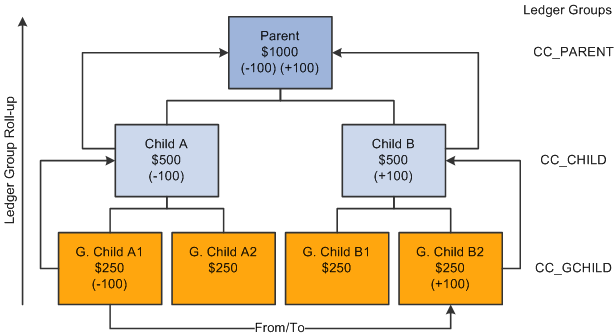

You also have the option to automatically generate parent-level budget adjustments from child budget adjustment entries.
See Generate Parent Budgets, Budget Adjustments, and Budget Transfers Automatically.
See Generating Parent Budgets, Budget Adjustments and Budget Transfers Automatically.

This diagram shows how a budget transfer initiated at the lowest level within a budget hierarchy is reflected at each level in the ledger groups hierarchy:
Parent budget impacts generated by child budget journal transfer
In this example, 100 USD is transferred from the budget G Child A1 to budget G Child B2 within the same CC_GCHILD ledger group. Assuming that you previously set up the option to automatically generate the parent budget impacts, when the originating child journal is posted, the impact to the CC_CHILD and CC_PARENT ledger groups is automatically generated and posted to the budget ledgers for each successive ledger group in the hierarchy.
