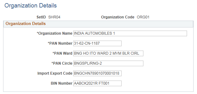

Use the Organization Details page (ORG_RGSTN_DTL_GST) to define GST data at the organizational level.
Navigation:
This example illustrates the fields and controls on the Organization Details Page. You can find definitions for the fields and controls later on this page.
| Field or Control | Description |
| PAN Number (permanent account number) | Enter the number that is assigned by the income tax authority to identify the organization's tax returns. This number is usually a 10-digit alphanumeric code. Oracle allows you to enter a 20-digit alphanumeric value. |

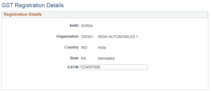

Use the Registration Details page (STX_RGSTN_DTL_GST) to define GSTIN data at the organizational level.
Navigation:
This example illustrates the fields and controls on the Registration Details Page. You can find definitions for the fields and controls later on this page.
| GSTIN | Enter the GSTIN number for the taxable entity |

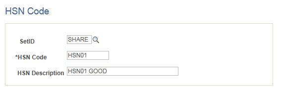

Use the HSN Code page (HSN_CODE) to assign an HSN code for a given good.
Navigation:
This example illustrates the fields and controls on the HSN Code Page. You can find definitions for the fields and controls later on this page.
| HSN Code | Enter the HSN code for the given good. HSN codes must be 4, 6, or 8 numbers in length and valid as per government specifications. |

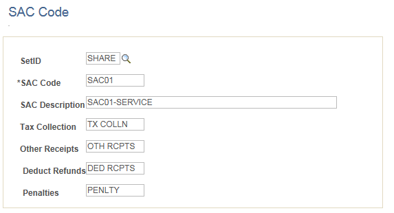

Use the SAC Code page (HSN_CODE) to assign a SAC code for a given service.
Navigation:
This example illustrates the fields and controls on the SAC Code Page. You can find definitions for the fields and controls later on this page.
| SAC Code | Enter the SAC code for the given service. SAC codes must be 4, 5, or 6 numbers in length and valid as per government specifications. |

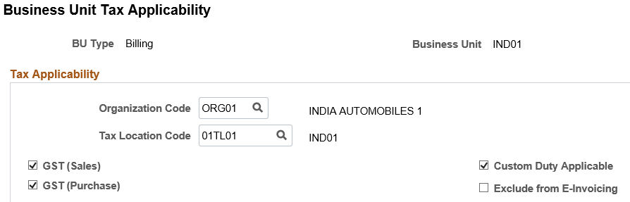

Use the Business Unit Tax Applicability page (ORG_BU_TAX_APPL) to assign a business unit to an organization and tax location code, and specify the business unit's GST and customs duty applicability.
Navigation:
This example illustrates the fields and controls on the Business Unit Tax Applicability page.
| GST (Sales) | Select this check box to enable GST for the Order to Cash cycle. |
| GST (Purchase) | Select this check box to enable GST for the Procure to Pay cycle. |
| Exclude from E-Invoicing | Select to indicate that PeopleSoft Billing excludes specific Billing business units from the E-Invoicing process. The Billing business unit displayed on the page is excluded from E-Invoicing requirements. |
