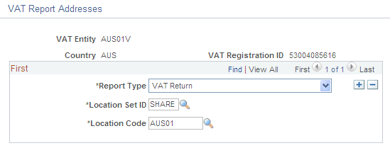

Use the VAT Report Addresses page (VAT_ENT_ADDR_SEC) to specify VAT report addresses.
Navigation:
Click the VAT Addresses link on the Identification page.
This example illustrates the fields and controls on the VAT Report Addresses page. You can find definitions for the fields and controls later on this page.
Note: You use this page to specify report addresses for your VAT return. These addresses can be used differently by each country. For example, in Germany, this page is used to print the address to which the VAT return is sent. Elsewhere, it is used to print the address of the reporting organization.
Field or Control |
Description |
Report Type |
Select the type of VAT report. Values are:
Location SetID and Location Code |
Select the location SetID and code to use for the address. |
You can add multiple rows for different report types. Click OK to save your changes and return to the Identification page.

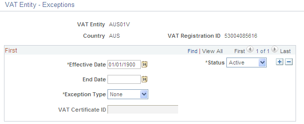

Use the VAT Entity - Exceptions page (VAT_ENT_EXCPTN_SEC) to indicate whether the VAT entity has been granted an exoneration or suspension from paying VAT in this country.
Navigation:
Click the Exception Details link on the Identification page.
This example illustrates the fields and controls on the VAT Entity - Exceptions page. You can find definitions for the fields and controls later on this page.
Field or Control |
Description |
Effective Date and Status |
Specify the effective date and status for each exception that you enter. |
End Date |
Enter the date that the exoneration or suspension ends, if applicable. |
Exception Type |
Select the type of exception. Options are: None. Exonerated: Select if the VAT entity is permanently excused from paying VAT. Suspended: Select if the VAT entity is temporarily excused from paying VAT. |
VAT Certificate ID |
Sometimes a government issues a certificate to show proof of an exception. Use this field to enter the VAT Certificate ID that was issued. |
Note: Generally, when an organization receives a temporary suspension from paying VAT, the suspension applies until a specific date or until the organization reaches a specified purchasing limit. Any limit based on the amount of purchases is not tracked in the PeopleSoft system; you must track it manually.

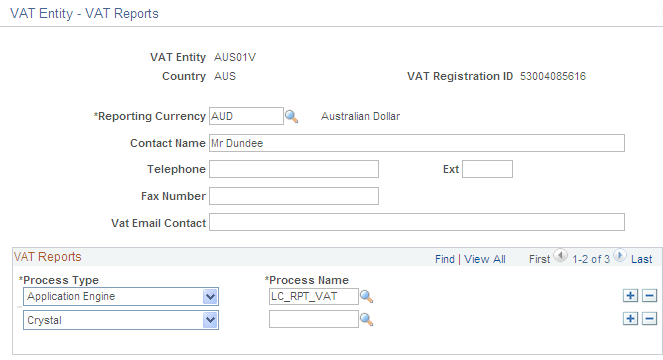

Use the VAT Entity - VAT Reports page (VAT_ENT_VATRPT_SEC) to define the contact information that you want printed on your VAT reports and the processes used to generate your reports.
Navigation:
Click the VAT Report Details link on the Identification page.
This example illustrates the fields and controls on the VAT Entity - VAT Reports page. You can find definitions for the fields and controls later on this page.
Field or Control |
Description |
Reporting Currency |
Select the currency to print on VAT returns for this country. If reporting currency amounts have not been entered on the transaction and if the transaction and base currencies differ from the reporting currency, conversion occurs when the report extract runs. |
Contact Name, Telephone, Ext, Fax Number, Vat Email Contact |
Enter the applicable contact information. |
Process Type |
Select the applicable process type for the report. |
Process Name |
Select the process name for this report. |
Note: You cannot run a VAT report unless you specify a process type and name on this page. You define a VAT report using the VAT Report Definition component described later in this topic.
