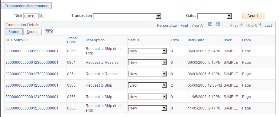

Use the Transaction Maintenance page (BCT_CTL_UPD) to view all electronic transactions in the transaction log and access the detail pages that enable you to correct transaction errors.
Navigation:
This example illustrates the fields and controls on the Transaction Maintenance page. You can find definitions for the fields and controls later on this page.
All transactional-based information appears on this page. The system displays the transaction code, which identifies the transaction type, and the transaction description.
Field or Control |
Description |
EIP Control ID |
Click this link to view the transaction line details for the transaction. Detail pages for each transaction type, which are accessible from this page, provide error messages and transaction details that enable you to revise fields containing errors. |
You can modify the transaction status here or in the Transaction Maintenance Detail pages. The rules for changing a transaction status are:
Current Status |
Change to Status |
New |
Complete (cancels all lines in the transaction). |
Error |
Complete (cancels all lines in the transaction). Reprocess. |
Complete |
Can't be changed. |
In Process |
Can't be changed. |
Reprocess |
Incomplete |
Can't be changed. |

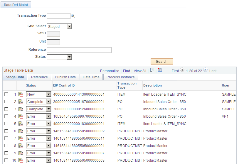

Use the Data Def Maint page (EO_EIP_CTL_MAINT) to view data detail or correct errors for inbound EIPs that contain data rather than transactions.
Navigation:
This example illustrates the fields and controls on the Data Def Maint (page). You can find definitions for the fields and controls later on this page.
All data definition transactions appear on this page. Detail pages for each transaction type, which are accessible from this page, provide error messages and transaction details that allow you to revise fields containing errors.
If you want to retrieve records by transaction, select one of these transaction types:

Field or Control |
Description |
Grid Select |
Some transactions are loaded into staging tables while others remain in the Integration Broker queue until they are successfully processed. Select Queue to view those residing in the Integration Broker queue and Staged to view those that are in a stage table. |
Search |
Click this button to display all the transactions that match the search criteria selected. Note: To display all of the records in the transaction log, leave the search criteria fields blank. |
Click the Show Detail Entry button to access the detail pages. Detail pages for each transaction type, which are accessible from this page, provide error messages and transaction details that enable you to revise fields containing errors. |
