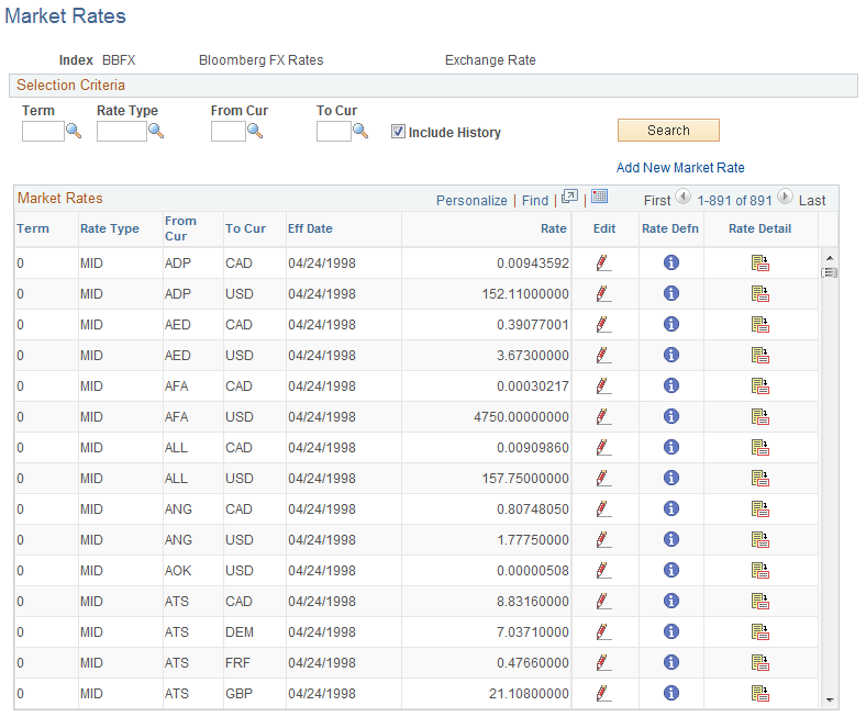

Use the Market Rates page (RT_RATE_TBL) to specify criteria by which to review rates and to add or update rates.
Navigation:
This example illustrates the fields and controls on the Market Rates page. You can find definitions for the fields and controls later on this page.
Note: The appearance of this page varies depending on the market rate category.
Selection Criteria
Enter the criteria by which to retrieve existing market rate definitions.
Field or Control |
Description |
Term |
Specify a term code, indicating the length of time the rate is effective. |
Rate Type |
Select a market rate or exchange rate type. |
From Cur (from currency) and To Cur (to currency) |
Select the original and conversion currencies of the market rate. |
Include History |
Select to view market rate history for returned results. |
Add New Market Rate |
Click to access the Market Rates detail page and add a new rate type. The market rate definition (and, in the case of exchange rates, the currency quotation method for the from currency and to currency) must already exist. |
Market Rates
Field or Control |
Description |
Click the Edit button to access the Market Rates - Market Rate page, and edit effective date and rate information. Note: To set up history rates for existing market rates, use the component in Set Up Financials/Supply Chain - Common Definitions - Market Rates. |
Click the Rate Defn (rate definition) button to access the Rate Definition page, and view information on the rate's maximum variance, error type, and day count basis. |
Click the Rate Detail button to access the Exchange Rate Detail page, and view exchange rate detail information. |

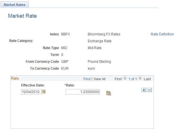

Use the Market Rates - Market Rate page (RT_RATE_PNL) to view details of a market rate, add a new market rate, and view exchange rate detail information.
Navigation:
Click Edit on the Market Rates page.
This example illustrates the fields and controls on the Market Rates - Market Rate page. You can find definitions for the fields and controls later on this page.
Field or Control |
Description |
Rate Definition |
Click to access the Rate Definition page, and edit variance and error type information for the rate definition. |
Click the Exchange Rate Detail button to access the Exchange Rate Detail page, and view rate information. |
Note: To use this page to add or change past rates, use the navigation: Set Up Financials/Supply Chain, Common Definitions, Market Rates, Market Rates. You must be in the correction mode to make changes to historical data.
