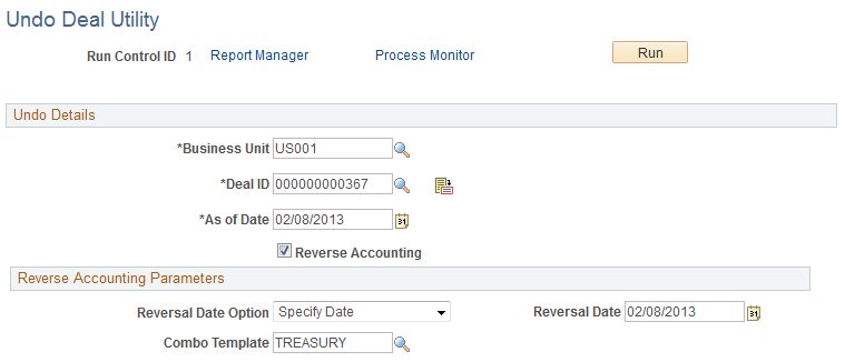

Use the Undo Deal Utility page (TRX_UNDO_DEAL_REQ) to deactivate a previously active deal and create the Accounting Entries for Undone Deals report.

This example illustrates the fields and controls on the Undo Deal Utility page. You can find definitions for the fields and controls later on this page.

Reverse Accounting |
Click this check box to enable the Reverse Accounting Entries Application Engine process (TR_RVSL_DRVR). You must enter reversal criteria in the Reverse Accounting Parameters section. |

Reversal Date Option |
Select the date to use as the accounting date for the reversal accounting entries. The Reversal Date field is available for input when the reversal date option is Specify Date. Select a reversal date from these values:
Combo Template |
Specify a ChartField combination editing template. |
