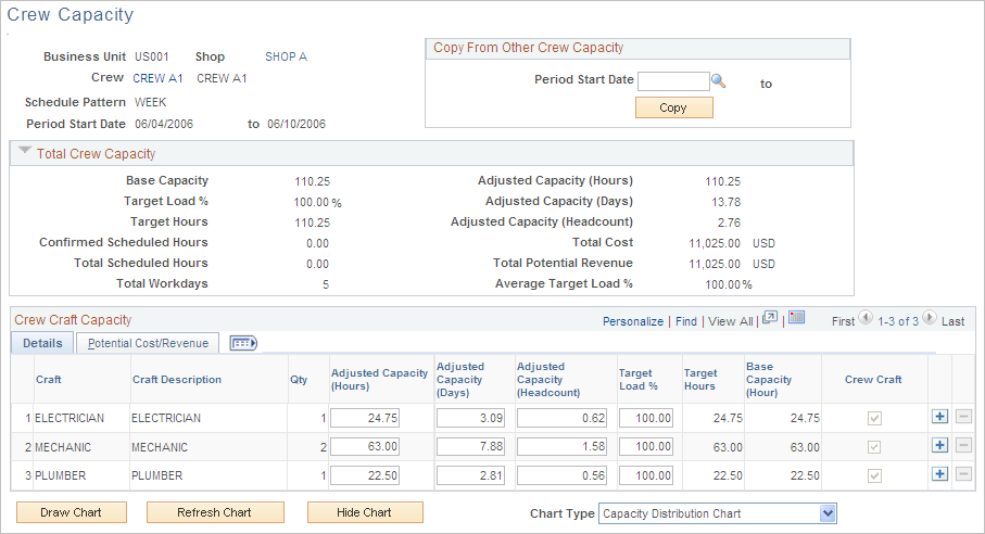

Use the Crew Capacity page (WM_CREW_CAPACITY) to define and update a crew capacity plan.
Navigation:
This example illustrates the fields and controls on the Crew Capacity page. You can find definitions for the fields and controls later on this page.
Note: To create a crew capacity plan, select a work order business unit, shop, crew, and a period start date on the Add a New Value page.

Total Crew Capacity
Field or Control |
Description |
Base Capacity |
Displays the total resource base capacity for the crew, which is derived from the hours in each resource's shift times the total capacity percentage of each resource assigned to this crew on the Define Crew page. Note: If the crew resources are associated with different shifts, the system calculates this value based on the different shifts. |
Adjusted Capacity (Hours) |
Displays the total adjusted capacity in hours for the entire crew. Total Adjusted Capacity = (Base capacity – All commitments) * Capacity allocation percentage of the each resource in the crew. This value cannot be negative. If a negative value is calculated, the system enters zero as the value. Schedulers can modify this value manually for each craft based on their knowledge of the technician's working hours for the period. Modify this value on the Details tab. Note: The accuracy of this calculation depends on the calendar entries of the resources for the specified schedule period and the currency of the resource management availability cache record. |
Target Load % (target load percentage [total crew]) |
Displays total target load percentage value for the crew (calculated at the crew level) = Total target hours / Total adjusted capacity hours Total load % = Total target hours / Total adjusted capacity hours. |
Adjusted Capacity (Days) |
Displays the total adjusted capacity in days for the crew. Total adjusted capacity days = Total adjusted capacity hours / standard hours per workday defined on the Shop Definition page. |
Target Hours |
Displays the total target available hours for the crew for the schedule period. Total target hours for the crew = Total target load percentage * Total adjusted capacity hours. Note: This value is used to schedule a crew. |
Adjusted Capacity (Headcount) |
Displays the total adjusted capacity in headcount for the crew. Total adjusted capacity headcount for the crew = Total adjusted capacity days / Total workdays in the schedule period. Note: The total workdays for a schedule period is based on the operating hours of the crew shop. |
Confirmed Scheduled Hours |
Displays the total confirmed number of hours scheduled for the crew on the Crew Scheduling Workbench, which means that the Confirm Metrics action was performed against the crew schedules. |
Total Cost |
Displays the total cost for the crew. Total cost for the crew = Sum of the hourly cost rate for each craft * Total adjusted capacity hours for each craft |
Total Scheduled Hours |
Displays the total number of scheduled hours of all of the crafts listed for the crew. This value is updated when you assign a work order task requirement to a crew for the schedule period on the Crew Scheduling Workbench, or when you change the period on the Crew Scheduling Workbench and save the page. |
Total Potential Revenue |
Displays a value, which is derived by multiplying the hourly bill rate for each craft times the adjusted capacity (hours) for each craft. This value equals the potential revenue for each craft. Add these figures together to obtain the total potential revenue for the crew. |
Total Workdays |
Displays total number of workdays, which is derived from the total number of workdays in the shift associated with the shop based on the schedule period. For example: If the schedule period is biweekly and the shift associated with the shop is 8 hours per day, 5 days per week, then the total workdays for this crew is 10. |
Average Target Load % (average target load percentage) |
Displays a weighted average of the target load percentage. Average Target Load % = SUM (Number of resources in each craft) * Target Load % of the craft) / Total number of resources in the crew capacity plan |

Crew Craft Capacity Details
Access the Crew Craft Capacity - Details tab.
Field or Control |
Description |
Craft |
Displays one or more crafts based on the list of crafts associated with each resource on the Define Crew page. |
Qty (quantity) |
Displays the number of resources on the Define Crew page associated with a craft. |
Displays the adjusted capacity hours for the total number of resources in a craft. Adjusted Capacity hours (craft) = Base capacity for total number of craft resources – All commitments * Capacity allocation percentage of the craft resources Schedulers can modify this value manually based on their knowledge of the technician's working hours for that period. This adjustment is reflected in the total Adjusted Capacity (Hours) field in the Total Crew Capacity group box. Note: The accuracy of this calculation is determined by the calendar entries of the resources for the specified schedule period and the currency of the Resource Management Availability Cache Record. |
Displays the adjusted capacity in days for a craft. Adjusted Capacity (Days) for a craft = Adjusted capacity hours / Standard Hours per Day (Shop Definition) A scheduler can adjust this value. This figure changes when the scheduler adjusts the adjusted capacity (hours) value. Note: Adjustments to one value automatically adjusts the values in the other fields. |
Displays the adjusted capacity headcount for a craft. Adjusted capacity headcount for each craft = The adjusted capacity (days) / The total number of workdays based on the schedule period and the shop's operating hours A scheduler can adjust this value. This value changes if the adjusted capacity (hours or days) value changes. |
Target Load % (target load percentage) |
Enter the workload percentage for this crew taking into account any unscheduled or emergency work that might come up during this schedule period. This percentage is used to calculate the target hours for this craft. |
Target Hours |
Displays the target hours for each craft. Target hours for each craft = Target load percentage for the craft * Adjusted capacity hours for the craft |
Base Capacity (Hours) |
Displays the base capacity hours for each craft. Base capacity hours for each craft = SUM of the resource's weekly shift hours * Capacity percentage specified for the resource on the Define Crew page |
Crew Craft |
A check mark appears in the check box as display only if the listed craft is associated with this crew. Note: The system selects and deselects this check box depending on whether you associate a craft with a crew. |

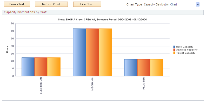

Draw Chart |
Click this button to display the crew capacity chart based on the crew capacity data for the schedule period. The system saves the page before displaying the chart. |
Refresh Chart |
Click this button to refresh the crew capacity chart based on changes that you made to the crew capacity data. |
Hide Chart |
Click this button so that the chart is not visible on the page. |
Chart Type |
Select the type of chart that you want to appear. Chart types are:
