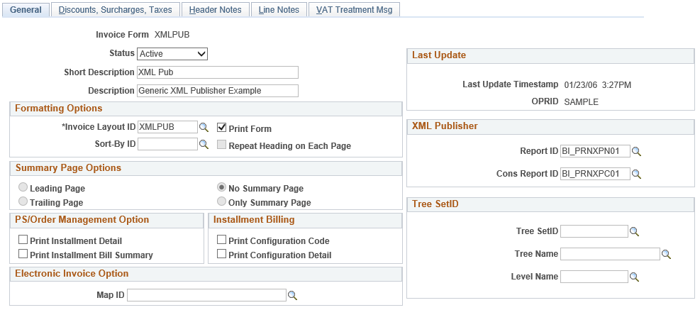

Use the Invoice Formatting Options - General page (BI_FORMAT_GENERAL) to create a new layout format or review existing layout formats.
Navigation:
You can define as many layout formats as you need.
Note: Most of the format options are used only by SQR invoice forms. If the layout format uses a BI Publisher layout ID, only applicable options are enabled. In addition, if the Print Form option is not selected, none of the printing options will be enabled.
This example illustrates the fields and controls on the Invoice Formatting Options - General page. You can find definitions for the fields and controls later on this page.
Last Update
Displays the date and time that the invoice form was last updated, as well as the user ID who performed the update.
Formatting Options
Select the invoice layout ID, whether the format is used in print mode, the sort by identifier, and whether headings are repeated for this invoice form.
| Field or Control | Description |
| Invoice Layout ID | Select an invoice layout ID from the following options:
 Note: To add a new invoice layout ID, you must add supporting logic to one of the printing programs. |
| Print Form | Select if you want to use the format in Print mode. This option must be selected to enable the other printing options. Note: If this option is not selected, invoices using this format will not be printed. |
| Sort-By ID | Select a value for the system to sort by for this format. |
BI Publisher
These are required fields if XMLPUB is selected in the Invoice Layout ID field. The XML templates are defined on the PeopleTools Report Definition page.
| Report ID | Select the report ID that identifies the template for nonconsolidated invoices. |
| Cons Report ID (consolidated invoices report ID) | Select the report ID that identifies the template for consolidated invoices. |
