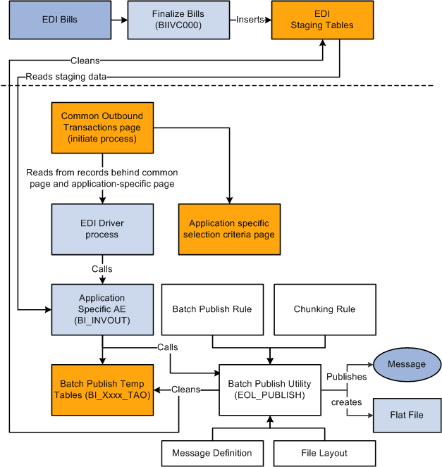

Running The Billing Invoice Notice Process (BI_INVOUT)
The Billing Invoice Notice process (BI_INVOUT) is a PeopleSoft Billing Application Engine program that the system calls from IN_PUB_MSG when you publish an EDI bill. BI_INVOUT is an Outbound Message publish program that uses the Batch Publish method. It calls the EOL_PUBLISH library to publish XML messages containing the invoice information.
Note: To publish an EDI bill you must select EDI as the Invoice Media on the Address Info page of the bill.
When the Publish Outbound Message is complete, it clears the BI_HDR_EC table. If you need to re-transmit invoices, select the Re-transmission check box on the Billing Invoice Notice Message Selection Criteria page, complete the fields in the Invoice Re-transmission group box, and the system will re-write the specified invoices to the BI_HDR_EC table. These invoices can then be re-transmitted.
To view the service operation output, use the Service Operations Monitor.
See PeopleTools: Integration Broker, "Using the Service Operations Monitor"
This diagram illustrates the Billing Invoice Notice process flow from EDI bills to a flat file.
Note: The message records used in BI_INVOUT are vulnerable to fragmentation due to frequent deletes and inserts. Database administrators should maintain the Message Definition BI_Xxxxxxx_TAO records at regular intervals. To avoid fragmentation, database administrators should drop and recreate these records during the lag time, when these tables are empty. The frequency of defragmentation required for these tables depends on the volume of data processed through this program. Depending on the database platform (Oracle/SQL Server), database administrators can also issue a TRUNCATE command on these records to ensure that this program runs more efficiently.
