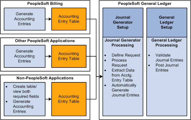

The following process flow illustrates how the Load GL Accounting Entry process fits into the overall journal entries generating process.
You must populate the PeopleSoft Billing Accounting Entry table (BI_ACCT_ENTRY) with accounting entries before you can create PeopleSoft General Ledger accounting entries.
The Load GL Accounting Entries process (BILDGL01) populates the Billing Accounting Entry table with accounting entries that the Journal Generator eventually picks up. The process selects for processing all bills in the specified range selection that have a status of INV and that have finished the Billing Currency Conversion process and the Pre-Load process.

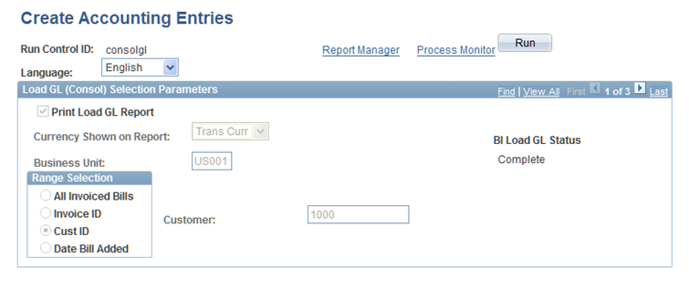

Displaying Load GL Requests that Process Successfully
The system updates the status on the Load GL Process table to indicate that processing is complete before it carries out the last SQL Commit command for the corresponding request. After all requests for a run control are processed, the system deletes all records in the Load GL Process table for the corresponding run control. When multiple requests are all processed successfully, the Load GL Accounting Entries and Load GL for Consolidated Bills pages are displayed.

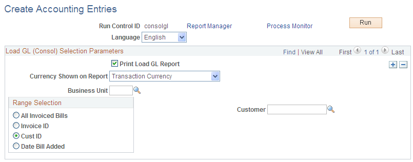

This example illustrates the fields and controls on the The Load GL for Consolidated Bills page when multiple requests are processed successfully.
In this scenario, the system does not display the BI Load GL Status and Restart Process Instance fields. If the system processes successfully all requests within a run control, the parameters for the request are available to edit.

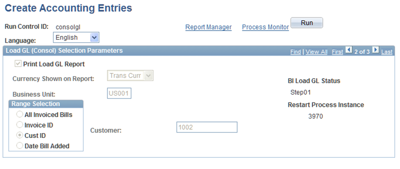

Displaying Load GL Requests That Terminate
The run control may contain a Load GL request that does not process successfully. On the Load GL Accounting Entries or the Load GL for Consolidated Bills page, the BI Load GL status indicates that the process is Complete for those requests that process successfully. The parameters for requests that process successfully are not available for edit when succeeding requests within the run control terminate.
This example illustrates the fields and controls on the Displaying the updated BI Load GL status as Complete, and the parameters that are not available for edit.
If a request terminates after a SQL Commit command, the Load GL process saves the process instance and process status number on the Load GL Process table. The Load GL Accounting Entries or the Load GL for Consolidated Bills page displays the BI Load GL status of the aborted request and the Restart Process Instance number. All other request parameters are unavailable for entry.
This example illustrates the fields and controls on the Displaying the BI Load GL status of the aborted request and the Restart Process Instance number.
All requests not processed, those that follow a terminated request, can be modified. You cannot delete a Load GL process request that must be restarted.
