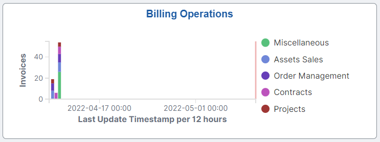

This example illustrates the Billing Operations tile.

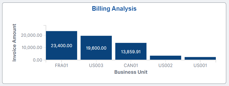

            This example illustrates the Billing Analysis tile.
