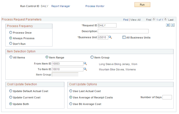

Use the Update Default Actual Cost page (RUN_CM_DFLTCOST) to calculate the value to be stored in the Default Actual Cost field or the Current Purchase Cost field on the Define Business Unit Item - General: Common page.
Navigation:
This example illustrates the fields and controls on the Update Default Actual Cost page. You can find definitions for the fields and controls later on this page.
Use the Update Default Actual Cost process to update the cost fields Default Actual Cost (DFLT_ACTUAL_COST) and Current Purchasing Cost (CURRENT_COST) in the Define Business Unit Item - General: Common page (BU_ITEMS_INV).
Field or Control |
Description |
Business Unit |
Enter the PeopleSoft Inventory business unit in which the process updates the cost fields for item IDs in that business unit. All items meeting the search criteria on this page are updated, regardless of the cost profile used. |
All Business Units |
Select all Inventory business units. The process updates the cost fields for the specified item IDs in all of the business units. If row-level security is enabled, then the user must have security access to all of the Inventory business units for the process to run the cost calculations. |
All Items |
Select this option to include all items in the business units that meet the search criteria of this page. |
Item Range |
Select this option to define a range of item IDs to be processed. |
Item Group |
Select this option to define an item group ID to be processed. |
From Item ID and To Item ID |
Enter a range of item IDs to be processed. The system includes all items in the alphanumeric sequence. The Item Range option must be selected to enter values in these fields. |
Item Group |
Enter an item group ID to be processed. The Item Group option must be selected to enter a value in this field. If the Item Group option is selected and the Item Group field is left blank, then the process includes only the items that do not have an item group assigned on the Define Item - General: Common page (MASTER_ITEM_TBL table). |
Cost Update Selection |
Select the cost fields to be updated by this process. The options are:
Cost Update Options |
Choose the method to update the cost fields. The options are:
Number of Days |
Enter the past number of days' worth of receipts to be used to calculate the weight average for the transfer price. The field is required when the option Use Average of Receipt Costs is selected. |
